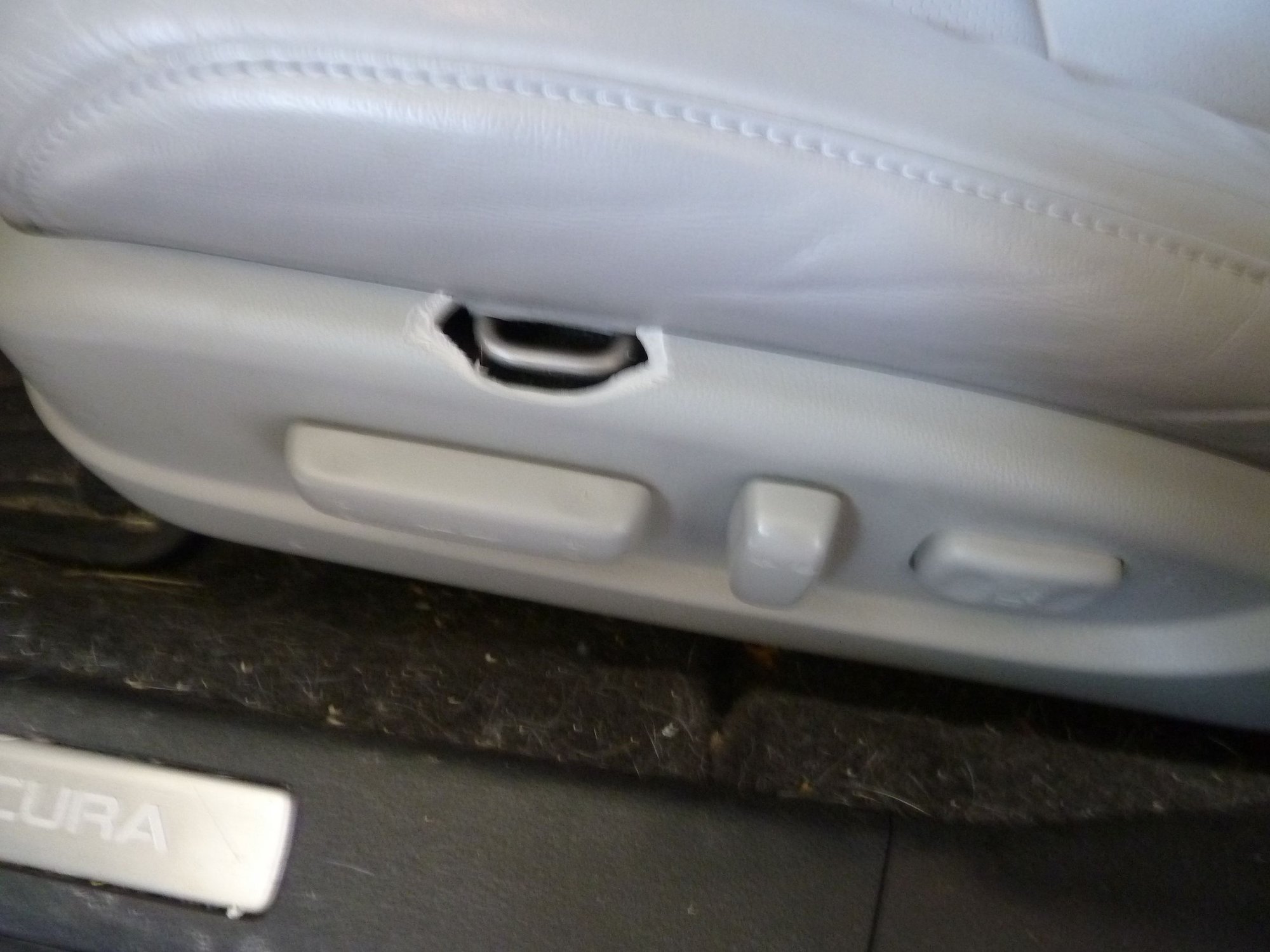

2015 tlx driver's side seat trim broke because the
seat spring (or something) pushed up against the plastic and broke it.
Pic attached.
any 1 else experience this?
took car to dlr, they said acura doesn't cover trim under warranty
i said we'll see about that
this is a defective seat issue
I've escalated this issue to the district service manager.
Damage to plastic trim caused by that piece of metal...whatever it is.

Mine did it too, a bunch of people had it happen, the replacement part number looks identical on the outside but is reinforced in that area... but Acura says its not due to a design issue on their part.

I was told I had to pay $60 for the part and $85 to install it.
Is that what you did?

i ordered the part online and swapped it myself, its relatively straightforward except for the lumbar switch i almost destroyed getting it out

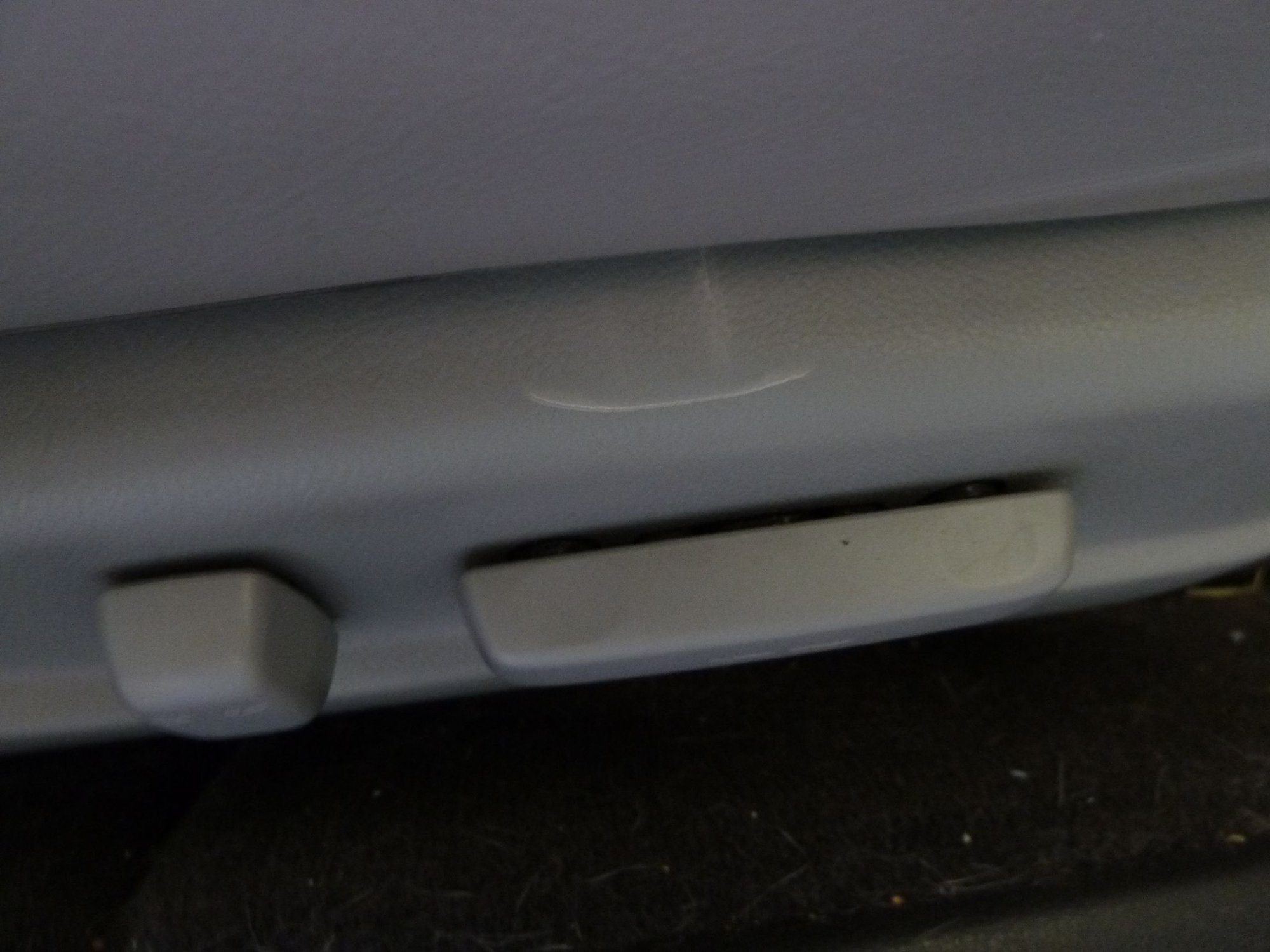

FYI now my passenger seat is doing the same thing.
Attached is a pic of the outline of where the damage will be.
Acura service told me either Acura pays or I pay.
I assure you it won't be me.
passenger seat trim damage beginning, breakaway soon

Mine is starting to show signs of breaking through also.

it definitely is a defect and Acura knows it, I wish i had a picture but when i swapped mine there is definitely more material and structural reinforcement in the new trim piece that isnt present in the one that broke
