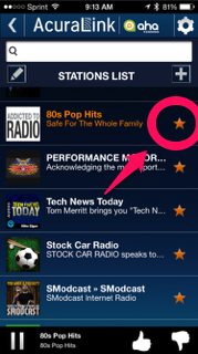

I've not been able to understand how the aha app + acura streaming app + TLX radio is supposed to fully operate. So far this is what I've experienced:
- Each time I select 'aha' from the TLX audio menu on a new trip (aka, I've left the car with my phone and re-enter) I am forced to unlock my iPhone and re-confirm via a prompt that it is OK for the radio to connect through the acura streaming app
- Once accepted, I am able to only access the TED talk 'channel' via the TLX radio controls. The channel list only shows the TED talks and I see no way to change to other channels.
- I can switch to the aha app on my iPhone and change to any other channel, at which point the audio to the TLX changes accordingly, but as soon as I use the radio controls to try to switch again it is back to only the TED talks.
What am I doing wrong? Anyone else experience this?

In order to get your Aha stations to appear on the TLX entertainment system you must "star" them from within the Acura Streams app. Doing it in the regular Aha app won't do it for you.

"Aha"! Thanks for that. On past attempts tapping the aha button in the Acura streams app just resulted in an infinite "loading" graphic, but I just tried again and got to the screen you showed. Appreciated!

Like the previous poster said. You have to do everything within the acura link app the standalone aha app is prettyy much there just to setup the acuralink make sure you star the stations so they can show up on the car
