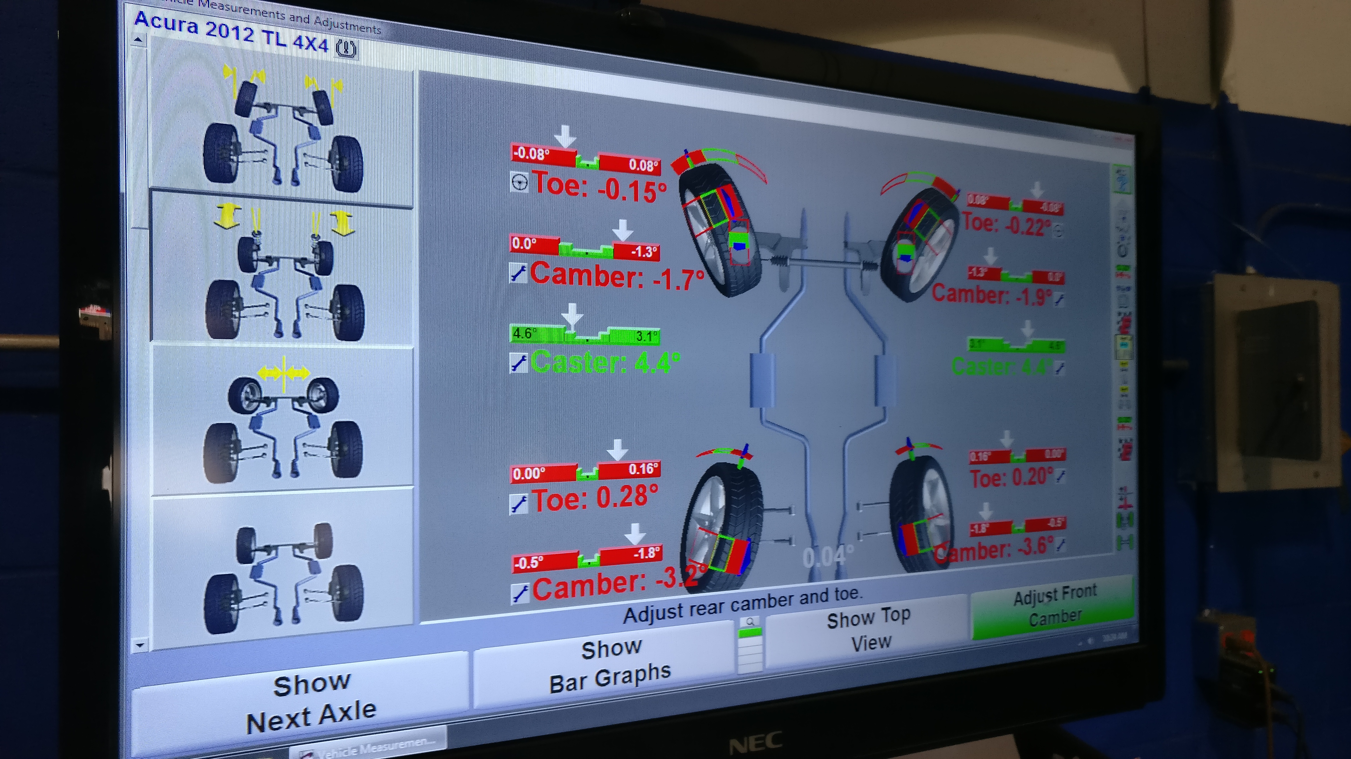

Went in for an alignment.. you could say it was off a little bit after lowering
It was fun getting it on the rack, too.
I didn't get a camber kit so there is nothing I could do in that sense, but at least the toe is in check at this point.
As for the previous comment, I will definitely be driving through the winter like this, lol.

As an update, have driven a couple thousand KM since the install/alignment. Nothing looks to be out of the ordinary in regards to tire wear, all is good!

You're lucky because that's a shit load of negative camber in the rear. I ended up having to buy a rear kit after I ran into wear issues for negative camber in the -2 region.

wreakYou're lucky because that's a shit load of negative camber in the rear. I ended up having to buy a rear kit after I ran into wear issues for negative camber in the -2 region.
Were you doing a lot of driving though? I'm at -2.5 in the rears and I was actually considering doing a bit more so that my rims/tires will clear the edge of the wheel wells.
Very little driving, I drive it 6K miles a year. I ruined a set of tires because of it, from my experience some tires are just more susceptible to wearing than others.

Camber shouldn't be ruining your tires that quickly. Having your toe out is what will do it.
