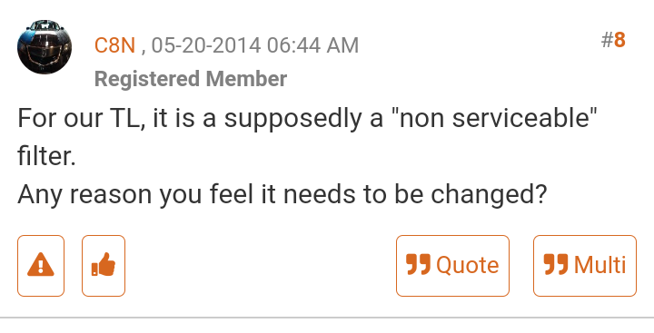

Saw this on another thread...... Is this true?

2012+ are serviceable but 2011 is not.

Spaced out for a second.. Only 6 speed auto have serviceable external filter.
