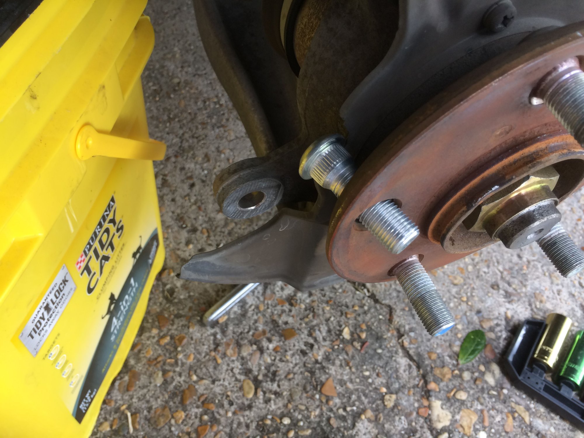

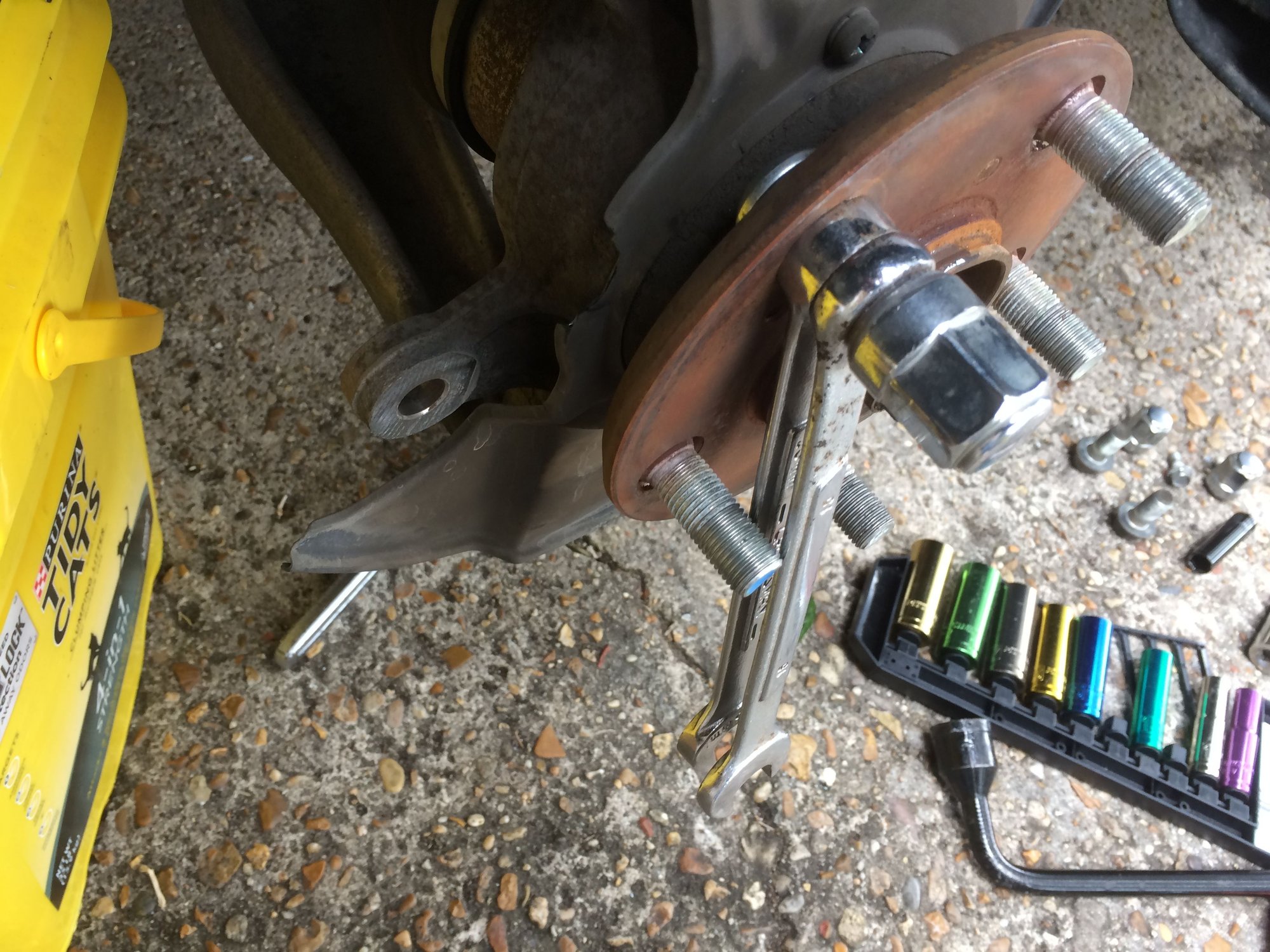

2008 Odyssey front stud replacement: Insert
2008 Odyssey front stud replacement: Pull-in
I changed a stud on a 2008 Odyssey and there was notched clearance in the dust shield to remove/install stud.
I haven't done this on a 4G TL but it might be similar.
I placed two box end wrenches on stud and tighten a lug nut to "pull-in" new stud.

I did have to jack-up the other wheel off the ground so I could turn the hub by hand to line up the stud with notch in dust shield.
And obviously I had to remove the brake caliper and rotor.
