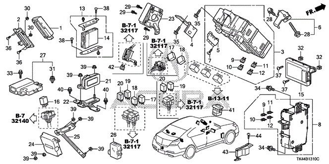

It's #15 in the picture fellas...to the right, rectangle...

Thanks for the reply.
This exploded view is kind of difficult to understand.
Is the module behind the center console or near the glove compartment?
