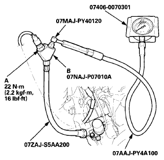

  10. Remove the rocker arm oil pressure switch (A), attach the special tools as shown in illustration below, then attach the rocker arm oil pressure switch to the oil pressure gauge adapter (B).
    Fig 1: Installing Special Switch And Rocker Arm Oil Pressure Switch With Torque Specifications
    G08069669Courtesy of AMERICAN HONDA MOTOR CO., INC.
  11. Start the engine.
  12. Do the VTEC TEST in the INSPECTION MENU with the HDS.
  13. Check the oil pressure.Does the oil pressure increase to at least 392 kPa (4.0 kgf/cm 2 , 56.9 psi)?
    YES - Replace the rocker arm oil pressure switch, then go to step 18.
    NO - Inspect the VTEC system. If it is OK, replace the rocker arm oil solenoid, then go to step 18.
