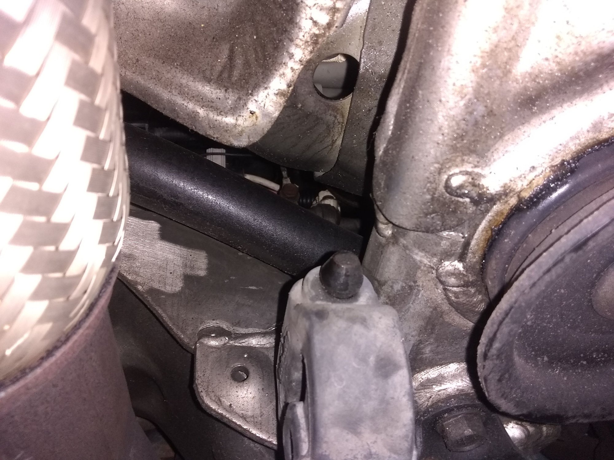

Heard clunk noise while driving... Got home soon after and there is a line of dripping in the driveway. I put a cup under the drip and it's water... Completely clear water? Weird. It's coming from beside the jpipe. Also noticed my coolant seems a little low but my coolant is blue and the drip is clear. Here's some pictures of the area. Does it look normal?

Hard to tell from pix but is there anyway this is the coming from your AC drain line? Have you been using your AC - it is late June?

Yes I was using the AC

a/c drip line

Yep ... normal. Only source of clear water in the car is the AC drain. Turn the AC on "recirc" and the amount of water shall diminish.
