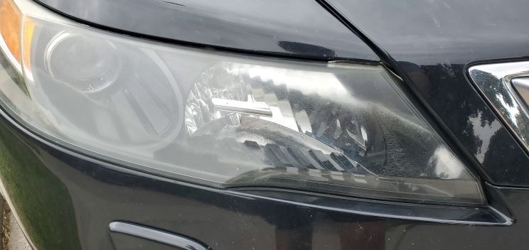

Hi,
Does anyone have any pics of the headlight vents on the 4G TL? I've been having a hell of a time trying to get the condensation out of my headlight (passenger side). Tried vacuuming it out and also blowing out with a blow dryer. The blow dryer was gradually changed from hot to warm to cool (air temp) and I finally got it all out but now it's come back, not more than a couple hours later. Doing some research led me to the fact that there are vents in the headlights but I couldn't figure out where they might be. May have to take the assemblies out completely and have a look. Also, one bulb wasn't working and when I looked at the igniter it seemed that there was rust on it so I'm guessing it's the problem, not the bulb.
Thanks in advance for any info anyone might have!
T

Did you take off the bulb when blow drying it to give the water a place to evaporate out of ? The vents should be on the back side of the headlight assembly.
I took off the low and high beams to get better air circulation. It did work but I'm guessing that the vents may be clogged with something - dirt, spiderwebs, etc...
I guess I'll have to try taking off the bumper off and also the headlight assemblies to see if there's anything there. Was planning on doing a headlight restoration anyway so I guess I'll try then. Was hoping to not have to take this step.
I was just hoping that someone had an idea of what the vents looked like and where they were located (exactly).

I would check for hair line cracks.

Make sure the seals on the bulbs are good, I had a bad turn signal that caused fogging. You can also stick silica packs in the headlight to absorb moisture.
