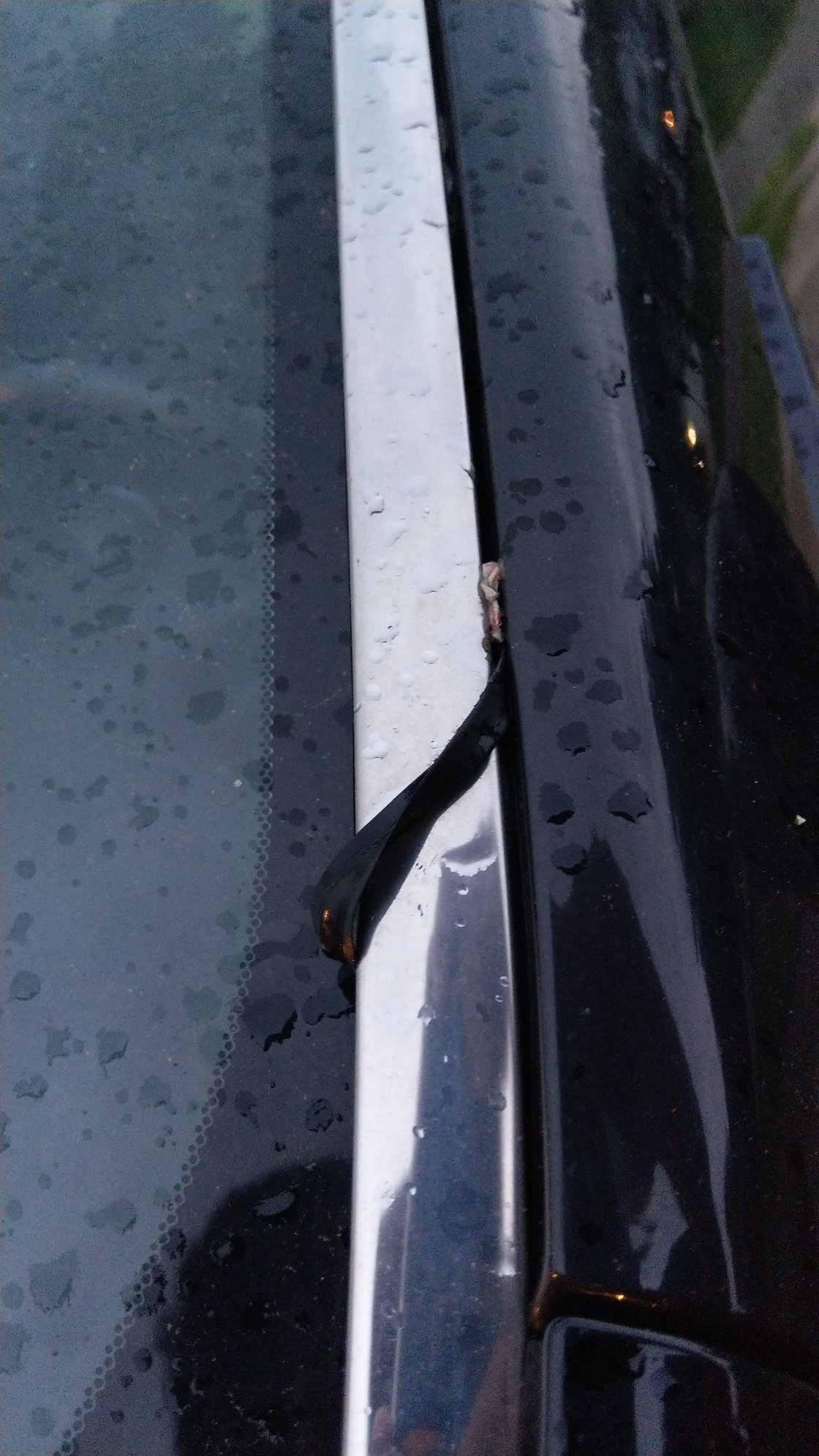

Old May 19, 2019 | 07:37 PM
RadioActive's Avatar
Joined: Sep 2013
Posts: 34
Likes: 6
From: Northeast Ohio
It's the rubber weather stripping type material underneath the silver trim that runs from the front to the back.
If you look closely, you will probably see where the rubber piece hits the paint. Paint will be worn, or wax removed.
I had this for a while, and keep forgetting to ask about a part number to order (cheaper from some dealers online than local...)
To temporarily solve, get other rubber stripping, or use a gum wrapper (that's all I had!) or something to push into the place where it's coming out. Wedge it back in there.
Last edited by RadioActive; May 19, 2019 at 07:43 PM. Reason: Add car wash comment! Added image!
