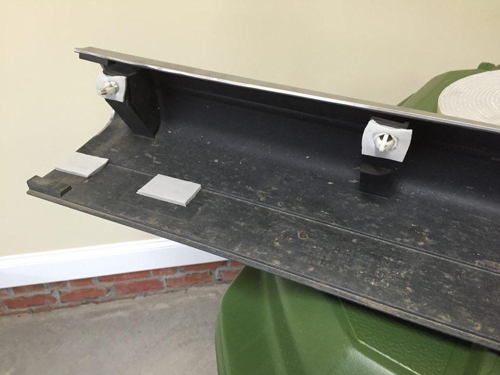

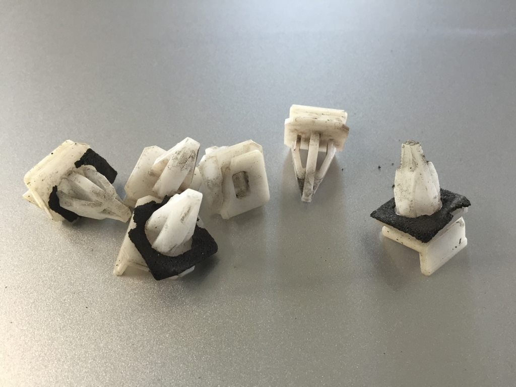

Make it easy on yourself- go to Home Depot and look in the area where weatherstripping is sold. It's typically a tape that's 3/4" x 5/8" (like a rubber tape- made by WeatherKing I believe), and what you do is cut it into small squares- I put them in the areas where the original thin rubber spacers were and also placed some underneath the car where the small plastic push pins push into the holes in the bottom of the car- it doesn't need to be insanely tight but should be snug when you try to move the side skirt.
Hopefully, this will be the end of your rattle. To take the skirts off, take off the 3 screws at the front and back of the skirt, then use a little force to pull them off the car- to replace, slide the 2 pieces of the side skirt together, push them into place, and replace the screws. Not too hard to do.

So probably a little overboard but I made sure to pad every single touchpoint or perceived touchpoint. Unfortunately that didn't do the trick. I noticed when I close my driver's door there's a little sound from the window maybe not sitting tight in the door. However, driving down the road, I opened the door enough for it to clear the pillar and the rattle is still there which leads me to believe it's coming somewhere else.

I did exactly that ^^...sorry it didn't work for you. Did you also pad the areas around the pushpins under the plastic sill? Mine are rock solid against the body of the car.
