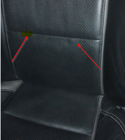

Hi guys. I just bought a 2012 4G SHAWD and love the car but am having an issue with the drivers side seat. I initially thought it was the lumbar system but after looking at it closer I have pinpointed the issue. It seems the SEAM in the seat has some type of metal or hard plastic in it that sticks out if you run your finger over it. Its about 2-3 inches in from each corner. (I will attach pic). The passenger side seat does not have this issue. When you engage the lumbar, it is more pronounced(which initially made me feel it was the lumbar mechanism). Does anyone have else have this issue ? The dealer was trying to tell me this is the way the seats are because their sport seats. BS. I am going to work with Acura corporate, but still I wanted to get feedback from other owners.

The arrows point to where its a little pointy in the seam.

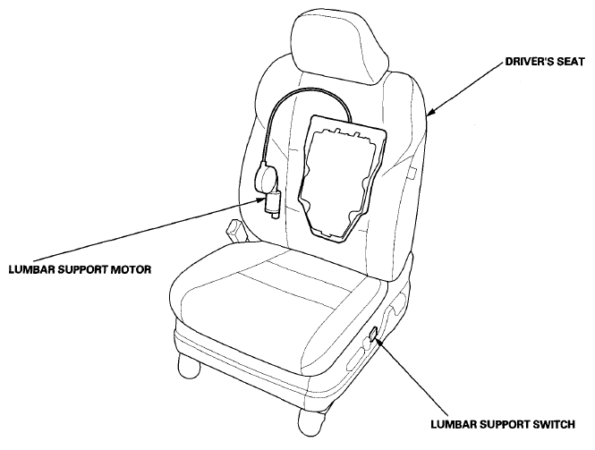

Here's the parts diagram and link to all the parts;
Acura Parts @ AcuraOEMparts.com - Genuine Acura OEM Parts from Delray Acura
Perhaps there is an issue with the clips that hold the seat heater up or something because there doesn't look like anything is really there.

I have the same problem with my 2012 FWD. It feels like a bar goes across the seat in the same area as you showed. I looked at Mitchells OnDemand5 and it shows the motor is on the right side of the seat and there is a cable from it to a flat looking piece of plastic in the upper part of the seat. It looks as if when you energize the lumbar it turns and pulls on that flat looking plastic making it buckle...think of it as a playing card in your fingers, the more you squeeze the card the more it bows out. My theory is the plastic piece or what ever it is has cracked and that's what we feel when you adjust the lumbar out. If I person takes the back cover off you should be able to view this. I'll try and paste a pic of the seat.

Having sean the actual seat cover, I do believe the issue is in the actual seat cover itself. There is a metal bar that runs along the seam and there are 2 plastic clips that hold this in place, They are right where I am experiencing discomfort. My dealer has ordered me a new seat cover, and a foam piece that is supposed to be inserted somewhere. I am going to have it installed tuesday so I will update the thread. But if you look at the actual seat cover(the pic I had was off ebay, since removed) you will see what I mean.

OK finally got this issue fixed !
The dealer replaced the seat cushion inside my seat and now its all good ! This was all done under warranty. Apparently the person who had my car before must have been a very heavy-set individual as a lot of the padding in the seat was mushed down causing the metal bar and clips that run along the seams in the seat cover protrude more than they should. The dealer showed me the cushion that WAS in my drivers seat and it was pretty mushed looking and parts of the side bolsters were ripping away from the main cushion. I'm not sure how heavy you have to be to do this but it seems the 4G TL was not made for very large people. The seat feels great now !
