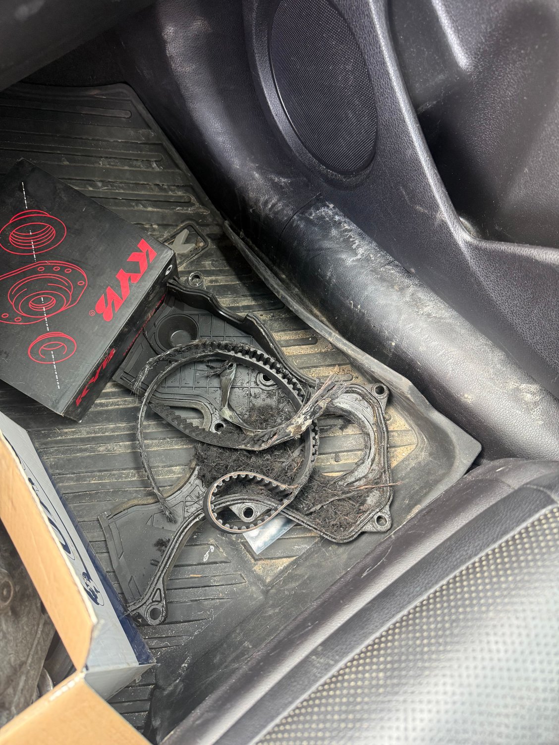

Hi everyone, the timing belt snapped on my 2014 RDX. I’ve been quoted $5500 CAD for a new engine. It has 308k kms on it and is worth about $4000 if it was running. I love this car and wanna fix it up. Any opinions?

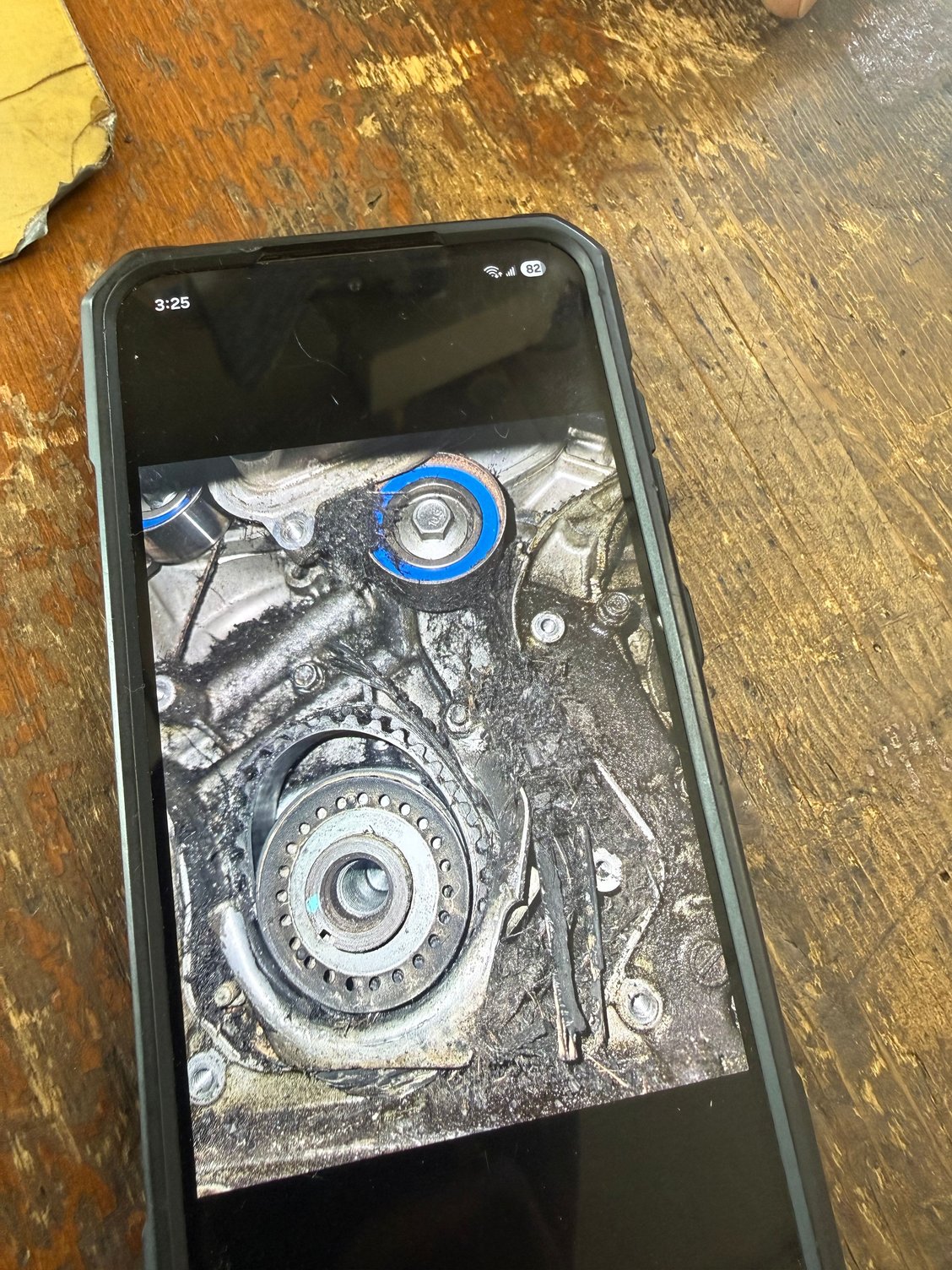

thank you for your response. It was well maintained before and I intend to keep it as long as I can. My last belt was replaced with pumps and pulleys 15k kms ago. It was a Continental belt from rock auto and it shredded. My mechanic said the pump and pulleys all look good and might have been a counterfeit

It looks like a heavy oil pump leak destroyed the belt.
Whether to replace the valves or the engine is up to you. But if there are no other issues with the car, I would keep it.
