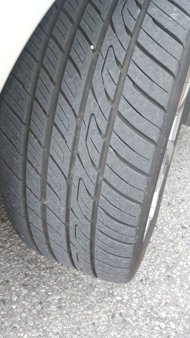

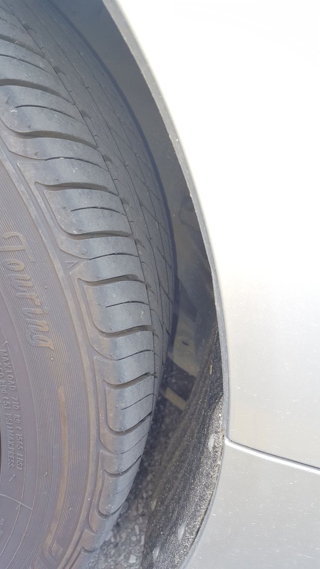

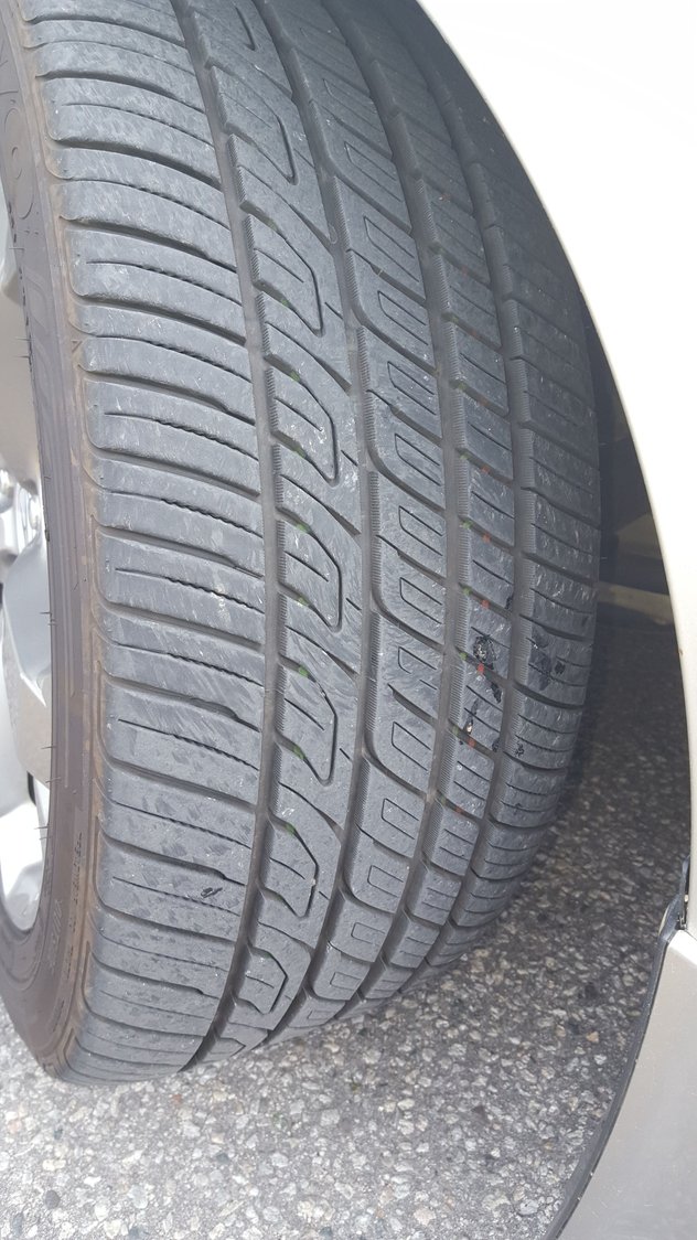

Old Aug 15, 2016 | 03:47 PM
AirUpThere7's Avatar
Joined: Aug 2016
Posts: 14
Old Aug 15, 2016 | 03:53 PM
Joined: Aug 2016
Posts: 14

Originally Posted by AirUpThere7
Those look like Toyo Versado LX tires.
Old Aug 15, 2016 | 04:48 PM
Joined: Aug 2016
Posts: 14
They are, they came with the vehicle upon purchase. I heard they are good.
