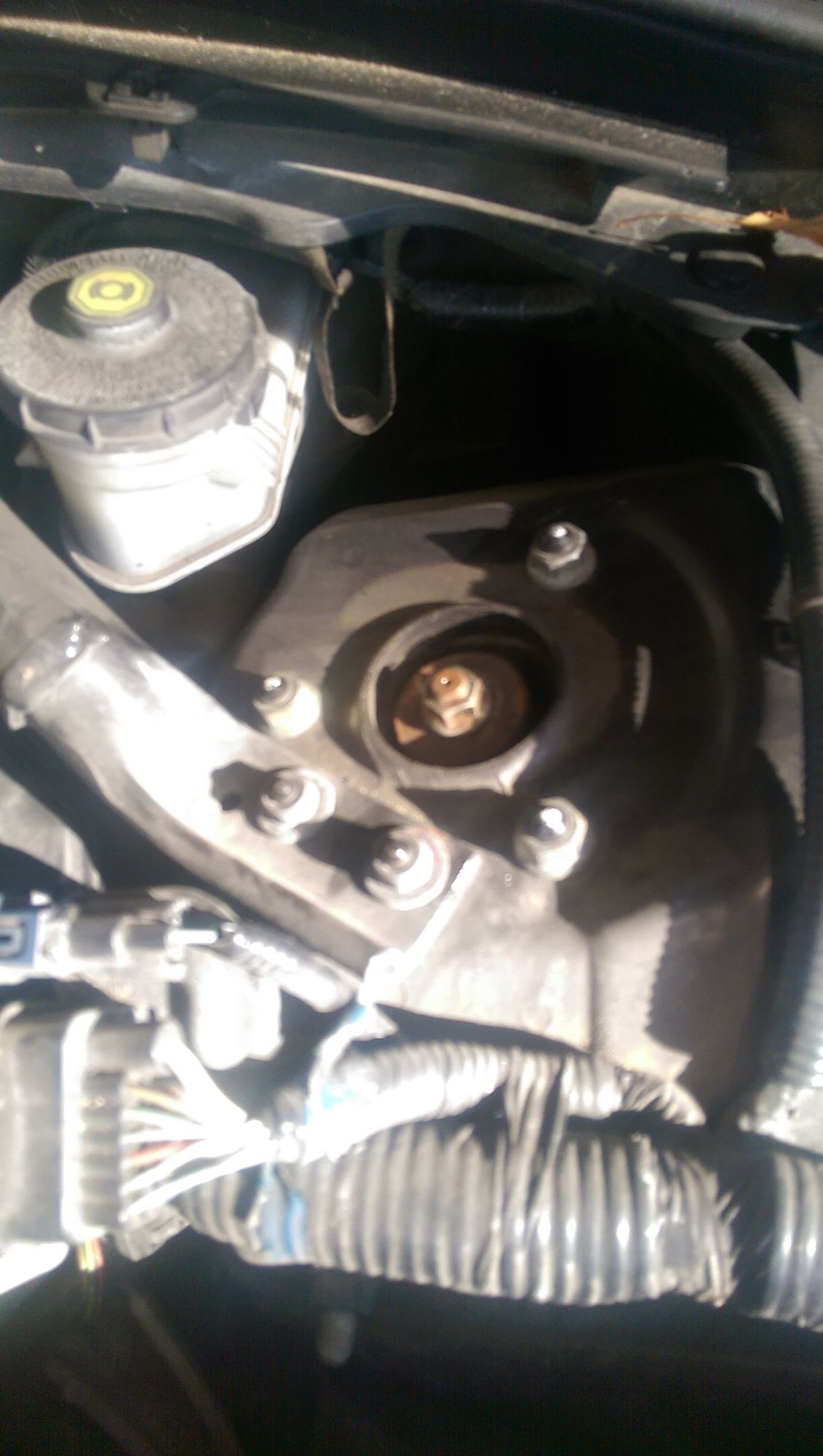

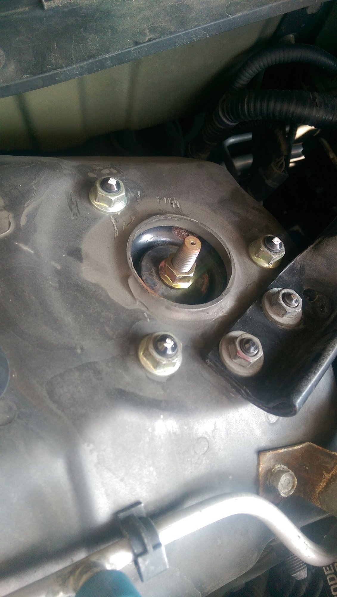

When I popped open the hood, I noticed the nut on the top of the strut on the driver's side was loosened quite a bit...see the pics below (sorry about the horrible pictures). I tightened that down, but have not yet driven it to test. Should this nut be tightened all the way down, or not?
Driver's side
Passenger side

I have a 2009 SH-AWD and both sides are the same length. Both the bolts on mine a bit rusty and stick out about 3/8 ths out or so.

typically, the bolt should be lower on the threads. How long have you owned this car? My guess is maybe someone worked on your suspension before, springs/shocks in particular and forgot to tighten it all the way. That side appears a lot more rusted than the other.

Yeah...I said in another thread that I had Tein coilovers put on about 6 months ago. I'm thinking the nut was never really fully tightened down because the front end feels better than it ever did after the coilovers were installed.

yup, it looks like the top hat is loose!
i imagine you could even tighten it on the car like that, since it's retaining load.

I did tighten it and all seems to be fine. Any other issues I should be concerned with?
Old Jan 27, 2015 | 11:48 AM
^I always play; Spot the difference!
which you played very well here. good job.
every component on the car will look like the other side.
if something doesnt look like the other side; something is wrong!
because the spring and top hat was loaded; i believe you came out great!
the spring and top hat shouldnt spin under load....
a test drive will confirm if you've done it correctly!
for a smooth test ride!

Thanks. Have been driving it since Saturday when I tightened it down and feels better than ever. Did 90 miles to work this morning and will do another 90 home tonight, so I think I'll be good.
