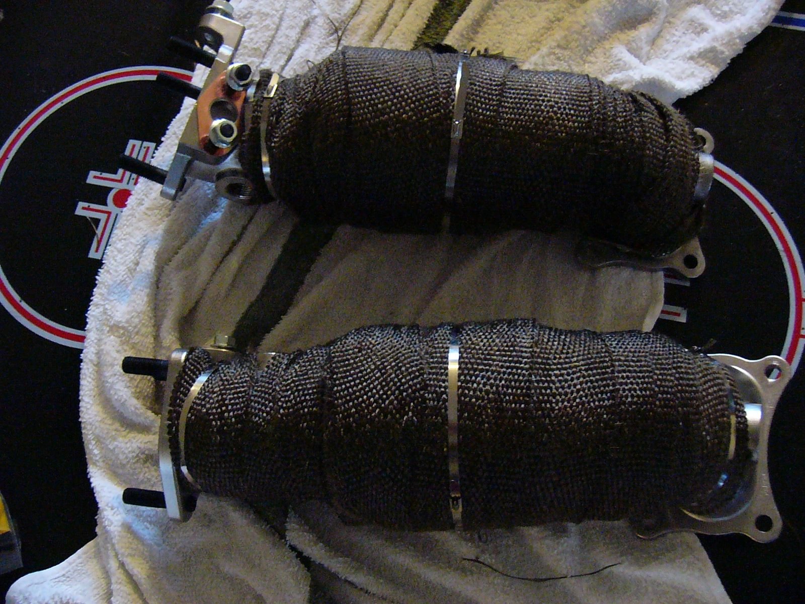

HFPCs are all wrapped up. Likely not my best work but I got it as tight as I could. It was harder than I thought it would be. Think it looks alright?

Mine look nearly identical to that. Good job.
