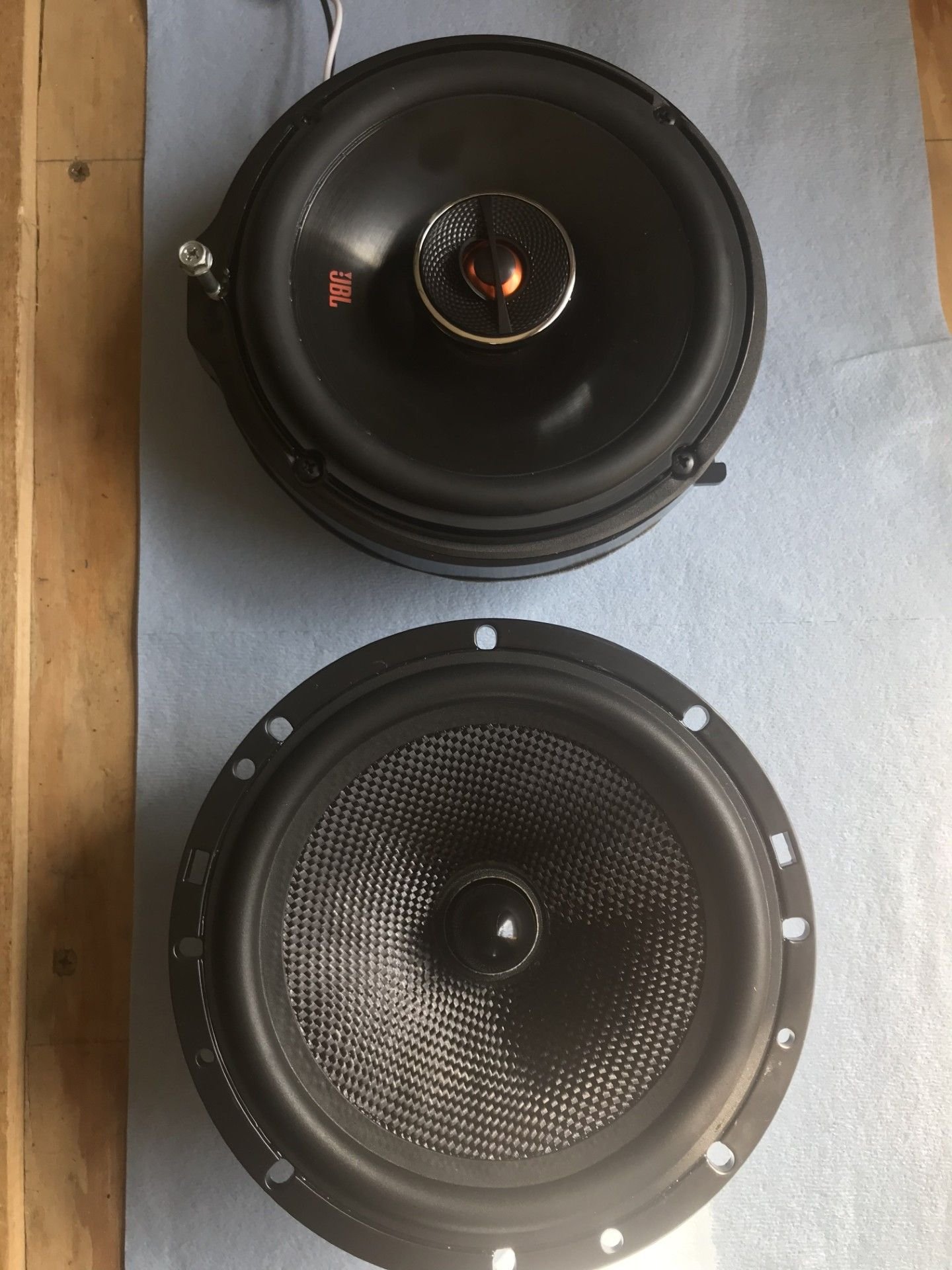

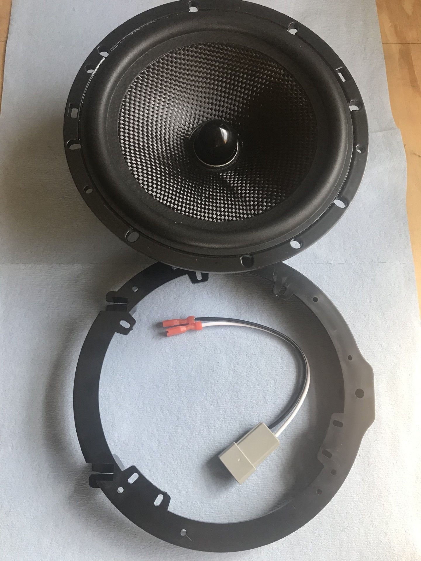

I have a 2014 TL SH-AWD with Tech Package w/ ELS sound system. When I purchased the car one of the stock rear deck 6.5" speakers was blown, so I decided to jump in and replace both rear deck 6.5" and both front door 6.5" speakers before they went as well. For reference I installed JBL GX628 GX Series 6.5" 2-Way Coaxial speakers in all 4 locations. Specs are as follows: 180W peak power (60W nominal), 50Hz-21kHz range, 2.3 ohms impedance (I believe the stock are 2 ohm, and this was the closest spec I could find as an aftermarket replacement). I used Metra 72-7800 Honda/Acura wiring harnesses to mate the speakers to the original OE harnesses without cutting any wires. Super clean and relatively easy install with the adapters I fitted to the speakers.
Once installed, all 4 speakers worked great for about a week and a half, until while driving one day the 2 front door speakers cut out and stopped producing any sound completely. I thought, like you, that something must have come undone and thought nothing of it. Fast forward a couple days and while driving on a rough road the 2 front door speakers came back to life and started working again (which I thought confirmed a ground out or loose wire somewhere). The following morning after starting the car, the speakers were not working again. It's been a couple weeks now with no sound from them and today I pulled both door panels and checked all connections, added some dielectric grease and reconnected everything....still not working. The two speakers that I installed in the rear deck are still working just fine, as is the center dash speaker (it's hard to distinguish if the A pillar tweeters are working, but from your post I suspect they may be out as well if they are in the same circuit as the front door speakers).
Not sure where to go from here, as I have a lot of mechanical experience under my belt, but very little electrical/sound system diagnostic experience. Curious if anyone else has had a similar problem and has found the solution...

Thank you for the reply justnspace. I am definitely going to start diagnosing more as soon as I get a chance. I thought that since the only modification to the my sound system was a simple speaker swap (I retained all factory wiring harnesses, amp, and head unit), this would be a common enough mod that others have done the same and experienced a similar issue without it being entirely specific to my case. The OP seemed to have the exact same problem, having also just swapped speakers and nothing else. Unfortunately, a resolution was never posted.
I'm beginning to wonder now if something happened to my factory amp and it messed with the channels going to the front door speakers. It seems intuitive that just replacing speakers that have a higher max watt range than the stock ELS junk would not damage the factory amp in any way (I may be wrong ???). Just wondering if anyone else has had a similar experience and knows which direction to go before I spend time pulling everything apart again and go poking around with my multimeter.
In taking your advice on checking power to the speakers: Would an AC voltage test at the factory speaker harness while the stereo is playing be the best way to check that? Or am I looking for an ohm resistance? Also, from what I have read, the factory amp is located in the trunk (passenger side), is there a way to test the output of the amp to the front door speakers to see if that is a problem as well?
A final thought: Would a single damaged wire in one of the adapter harnesses I installed cause all the speakers to go out at once, or just that speaker? I'm considering replacing them after testing for continuity since they are only about $15 a pair.
Sorry for my lack of knowledge here, like I said, I have rebuilt almost everything else on various cars, but when it comes to sound systems I'm pretty green...
