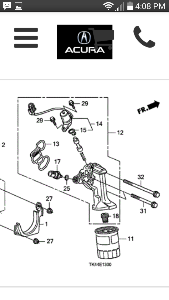

Anyone ever clean their VVT spool valve filter? Supposedly they can get gummed up and affect engine performance. Number 13 in parts fiche...

Actually after looking into it, I am intrigued to hear the feedback on it

That appears to be the same/similar VTC filter that I checked on my old K24A8 Accord that had about 90k miles on it, and it was perfectly clean. I don't think I've ever seen or read any information about that particular filter/strainer being a regular maintenance item, so the chances of it getting gummed up must be pretty low.

I'm actually seeing a leak in that area, so I'll likely end up replacing the entire assembly. I've also heard full synthetic isn't the best for our engines because of the VTEC. I'm going to switch to a blend, such as Kendall GT-1.

Your leak: It's actually a common problem for a leak to start at the vtec/oil filter bracket on H/A J engines. My mechanic friend repairs two or three per year. It's not a lot but it's also not zero.

That "gunk" on the drain valve is metallic (iron based) dust. It's the wear particles from the clutch packs. It's normal.
Based on internet suggestions I've taken about some spool valve assemblies on Honda transmissions.
Except for a little insignificant metallic dust they were clean.
You can change your VTEC bracket filter but I highly suspect it shall be clean. It's there to capture large chucks of debris if the oil filter is clogged and in by-pass mode.
If it's leaking you should change it anyway.
