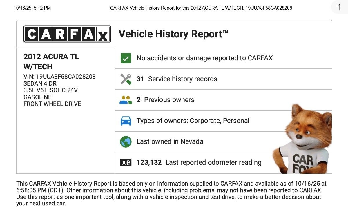

Yesterday, I purchased a pre-owned 2012 Acura TL Base. 123k miles.
Still "getting used to" the newer TL (previously owned 2000 TL). Transmission shifting seems "different" to me. I do not think anything is wrong. No reason to get it looked at professionally. Just "different". Hard to describe but it feels like when I go slow off the start, it somewhat "hangs". It's like - if I go harder on the gas, it shifts better. Sorry, really hard to explain. I do not want to say its slipping or banging. Often, I get a sensation like a "shuddering". Or like the RPMs rev up, but when off the gas it revs down and then up again quickly, then down again. Anyway, I checked the Service Bulletin but I do not believe it applies to my VIN number. So, I will not be taking it to Acura for the Software Update.
However, I am going to do a flush and fill (3 times, 3.3 quarts each time) before the end of the week. The CarFax shows the vehicle had a transmission flush 12k miles ago, but in August 2023 (previous owned did not drive the car much). The fluid is full and actually looks pretty good. Maybe I will be wasting my money by doing this flush, but I think I am going to do it and "baby" the fluid and see if it helps. Your thoughts?
Thank you very much. Appreciated.
