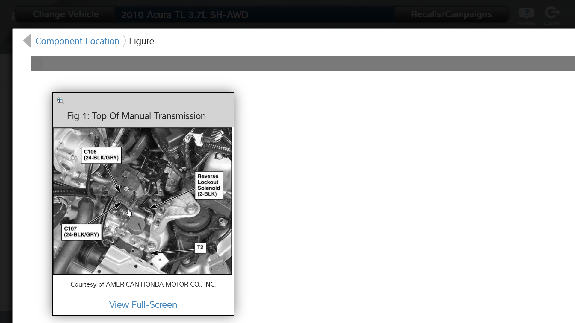

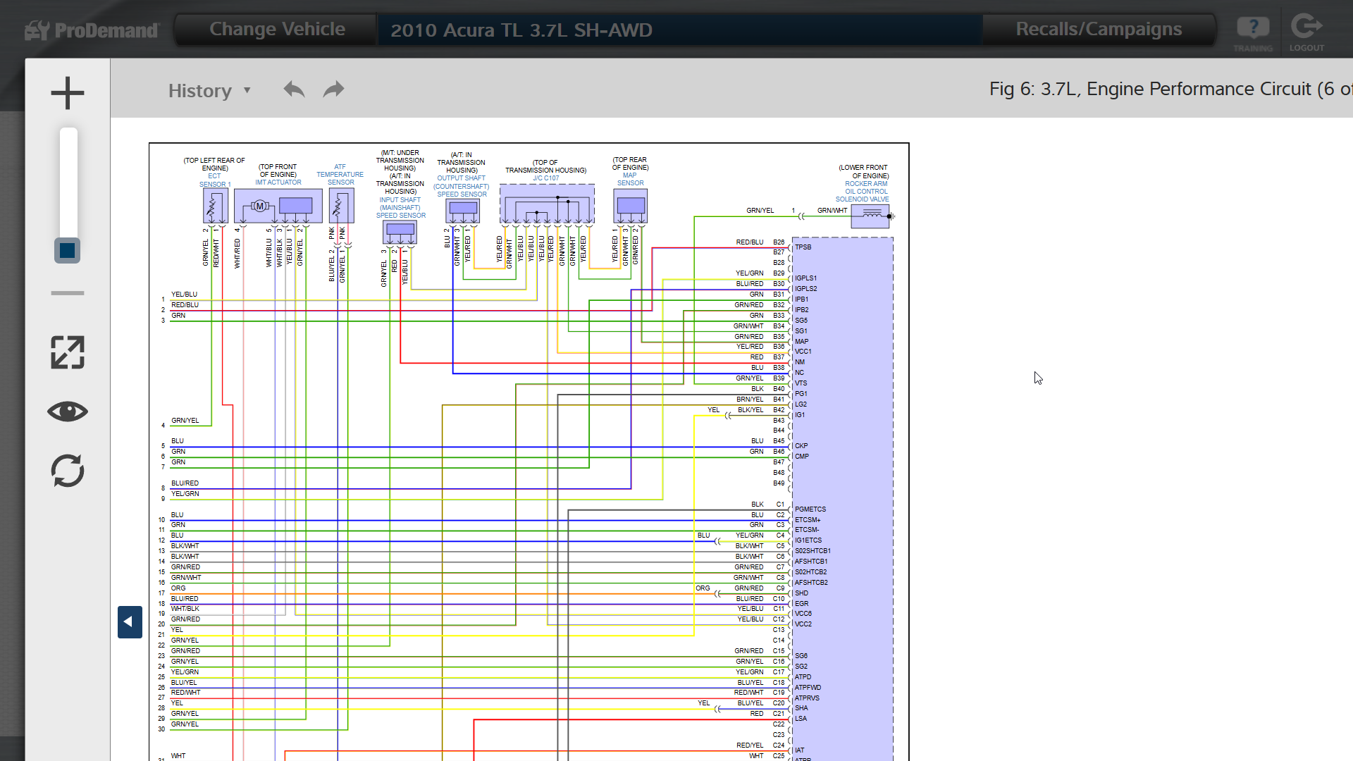

Check C107.

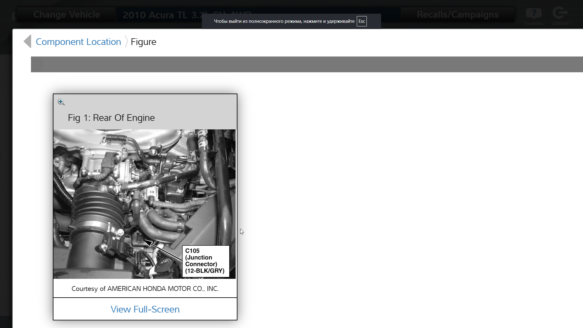

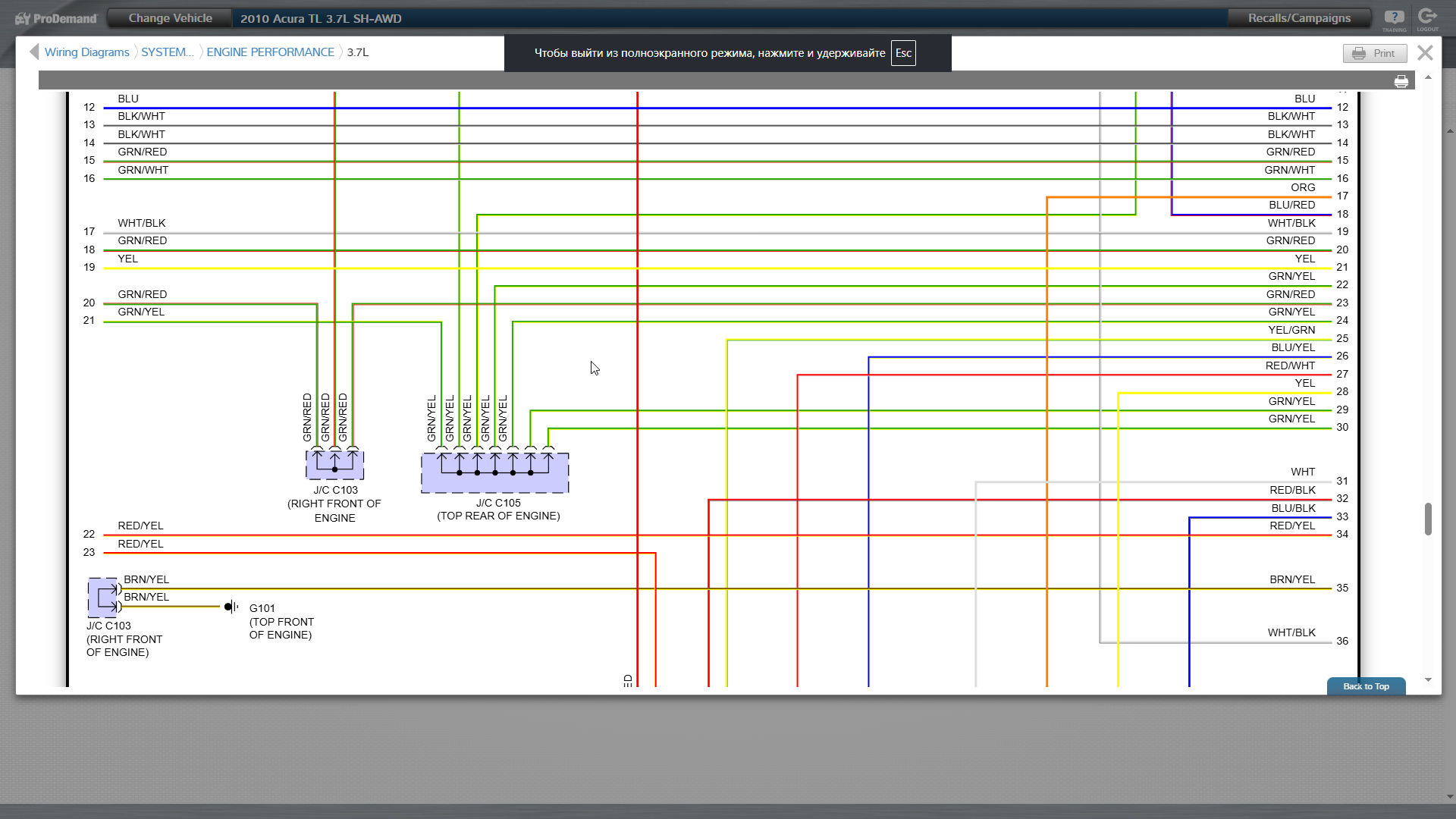

Then C105.
They also share a VCC power supply with the EGR valve. Try disconnecting it.
