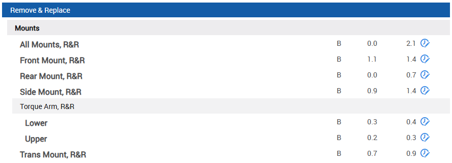

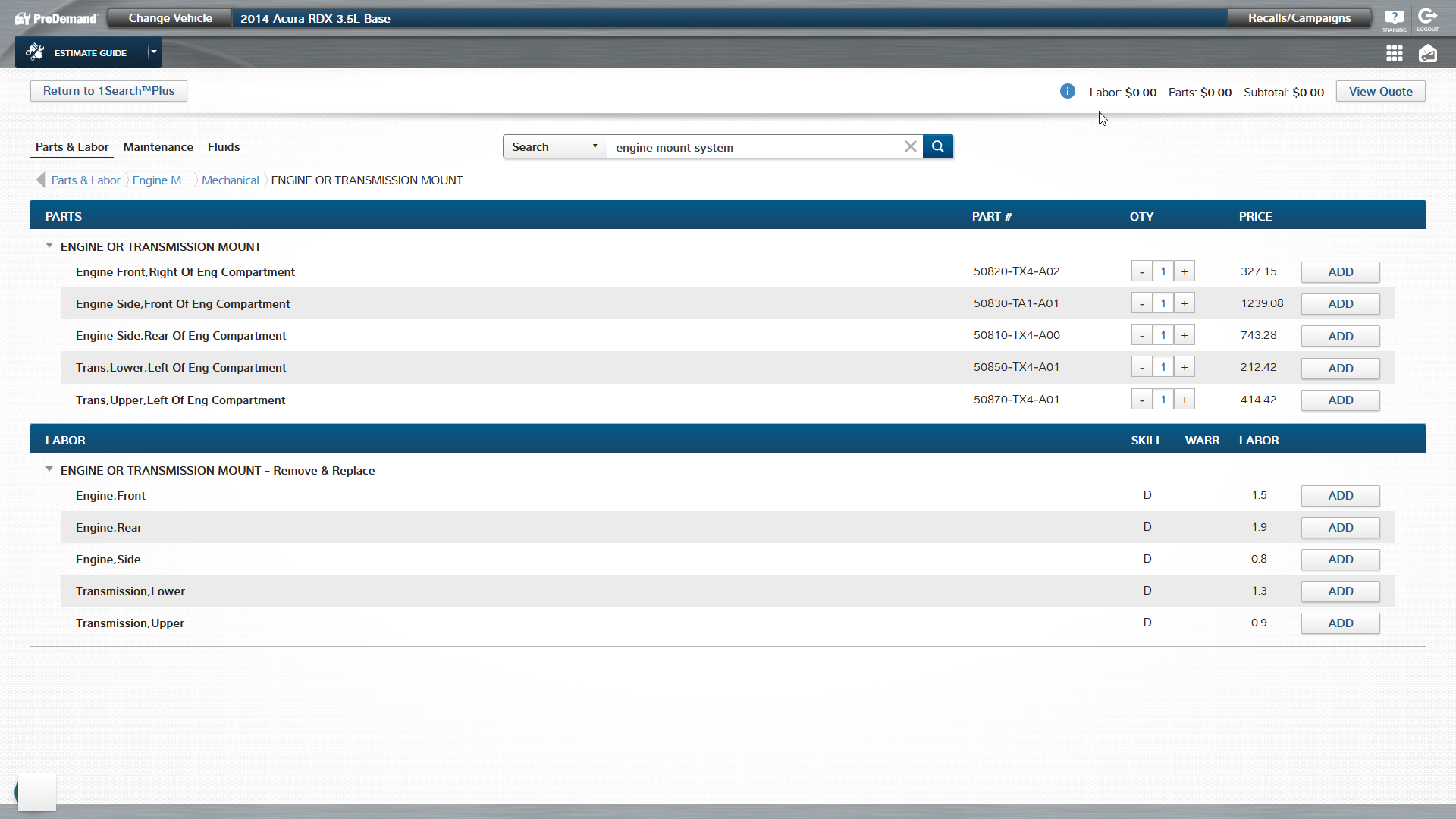

Chiming in because I'm about to throw some Anchor mounts in my RDX. At just under $200 for a set of four it was about a 5th of the price of OEM.
Doesn't look like the subframe needs to be dropped on this car, but the FSM has a very specific order for tightening all the bolts. Book time is 2.1 hours for all four mounts. Challenge accepted.

Book time 6.4 hours.

I'm seeing 2.1 on my 2011. Must be a lot more complicated on the 2nd gen RDX.
Spent a couple hours but only got the trans mount & lower torque rod done. Waiting for my new VTC oil control valve to arrive before doing the engine side mount since the latter needs to come out in order to access the former.
Side note: no idea what the front and rear mounts are here - there's only the left side trans mount, right side engine mount + upper torque rod, and bottom tq rod.

I only pay for Alldata for my 1st gen RDX. I don't have access to book times for other models, sorry.
But for what it's worth.., for me book time doesn't represent the actual amount of time it should take, but rather just how much of a pain in the ass the job is.
On the one hand, book time for my cabin air filter is 0.5 and I can change that out in like 5 minutes.
On the other hand, 1.2 for both lower ball joints... that's fine except when the castle nut is literally rust-welded to the knuckle, and it takes a gallon of PB blaster, a butane torch and 3-foot cheater bar to break it free.
Old Dec 22, 2025 | 05:37 PM
