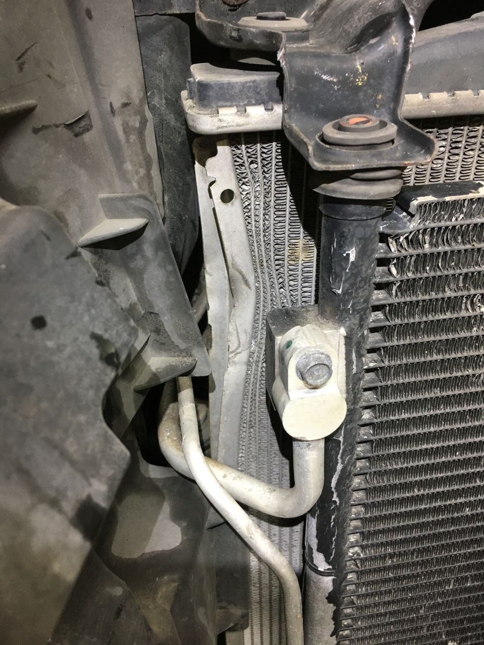

Thanks, I've almost finished it in two hours, but the radiator didn't survive(-$175, but he is 16 years old, so I was not upset.). There's not much room at the front, and touching the sharp side of the mount to the 16-year-old radiator resulted in a tiny, almost invisible micro-stream. So, be extra careful.
At 200,000 miles, the front was completely torn off, the rear was almost torn off, but dry. The mount on the transmission side was full of microcracks, worn out, and flexed twice as much as a new one. But the mount near the ABS seems better and more durable than a new one, so I'll probably keep it.

The Power Breaking Test said three mounts were gone, but in fact, only the front and rear ones need to be replaced. I finished everything today and only left the removed fan so I can replace the radiator on Tuesday (RockAuto is our everything). With my experience working on these cars, I can say it took me up to three hours to replace the front, rear, and upper transmission mounts. If you take your time, all four upper mounts can be replaced in four hours. The only equipment required is a good daytona or snaop-on jack and piece of 2x6 wood. Car lift is not required.

Absolutely not, in the fourth generation TL this job is done simply. The main thing is to be careful with the radiator

Time to call my buddy the pizza box to save the radiator when I have to do the job, or maybe a scrap piece of plexiglass! Great to hear how you did the job, your information is always epic and valuable!
Thank you very much, yes, I was thinking about getting some thin sheet of plastic to avoid similar situations. At 2022, my wife hit a deer, and now the radiator looks like this. I keep waiting for it to leak so I can replace it, but it never gives in. And this time, I honestly barely touched it and that was it.

Removing the radiator is not difficult, but there are issues with the transmission fluid lines, and there is always a good chance the old radiator may not survive removal and installation.

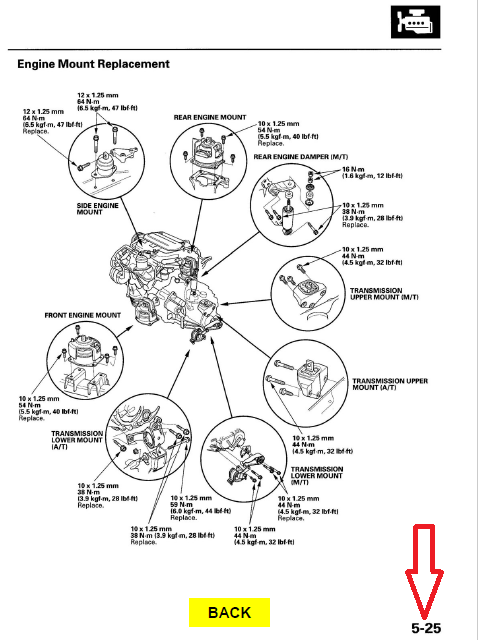

This is the extent of concentrated guidance the FSM gives in regards to 3G TL engine mount replacement.
One can find 'piece meal' information; however, you'd have to go through the 'Engine Assembly' areas of the FSM to find it.

Honestly, I didn't enjoy of this experience because the trans lines are underneath, and because of the installed splash shield, I had no desire to get under the car at all. Replacing the radiator on a car lift should be a very simple job.
But I spent 1.5 hours on this job.

A little power break test. Between this and some vibration or "movement" while driving, I suspect I need mounts....
https://m.youtube.com/shorts/_LyJt_dhnHw
The front one is torn off, the back one is probably okay.
