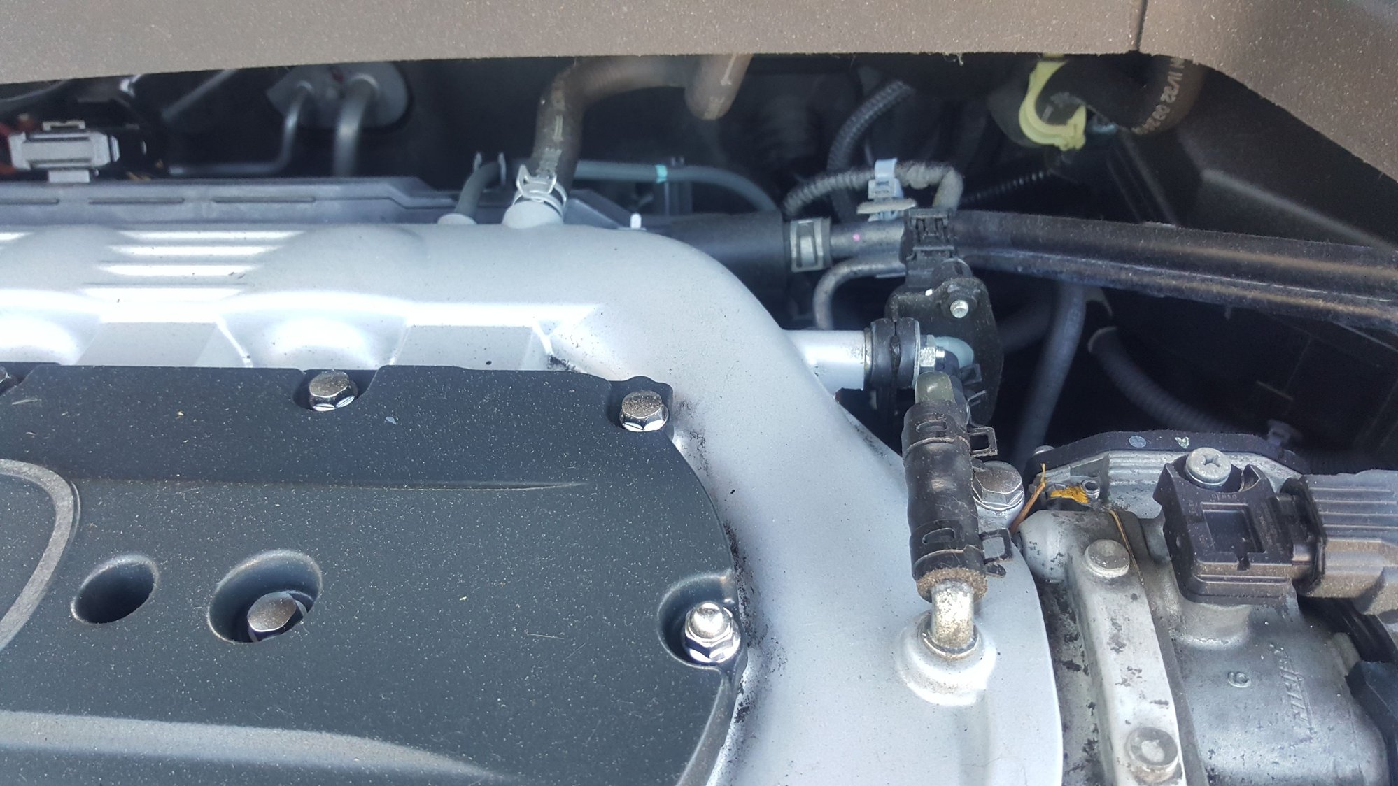

Could someone please tell me how do I seafoam my 4th gen TL??

I'm assuming you're taking about seafoaming through the intake. If so, the brake booster line is a good way. The brake booster line is the larger hose that runs from the back of the throttle body. However, that might result in more seafoam entering the rear bank. The other method is simply removing the intake and spraying it into the throttle body itself.
I haven't seafoamed my engine since I first purchased the car. Since then I've just used top-tier gas and occasionally thrown in the some Marvel Mystery Oil or Gumout Multi-System Tune-Up in the tank. Per my observations from using a boroscope, I literally have no carbon buildup on the valves or piston heads.

I know on my 3rd gen tl you would put the seafoam in the line connected to the throttle body manifold. There are 3 lines here which line should i use for the seafoam.
