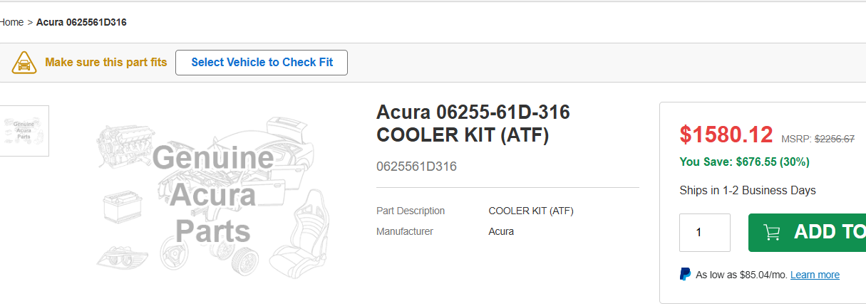

Not only are there zero online installation instructions available for your new specific 06255-61D-316 kit, there are no accurate pictures as well.
And that dealer MSRP price is ridiculously high.

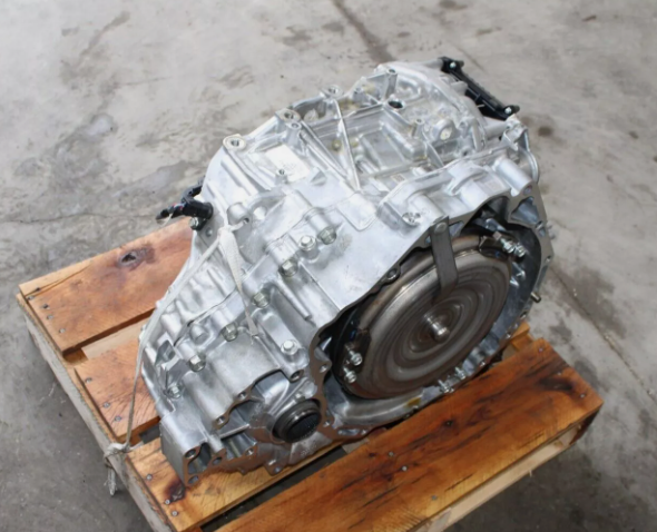

Not sure if this transmission mirrors what you have; however, it will give an idea of the cost for a used 2024 MDX 3.5 AWD 10 speed automatic with 2K miles.
$2,294.99+350 shipping before labor to install.
ACURA MDX 3.5L AWD AUTOMATIC TRANSMISSION GEAR BOX OEM 2024 -2K ONLY- | eBay
