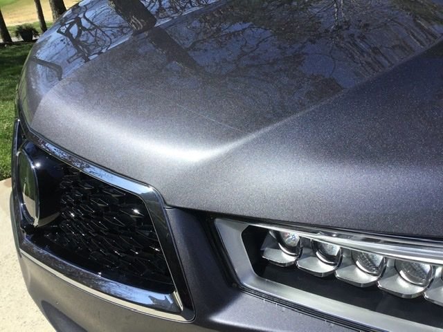

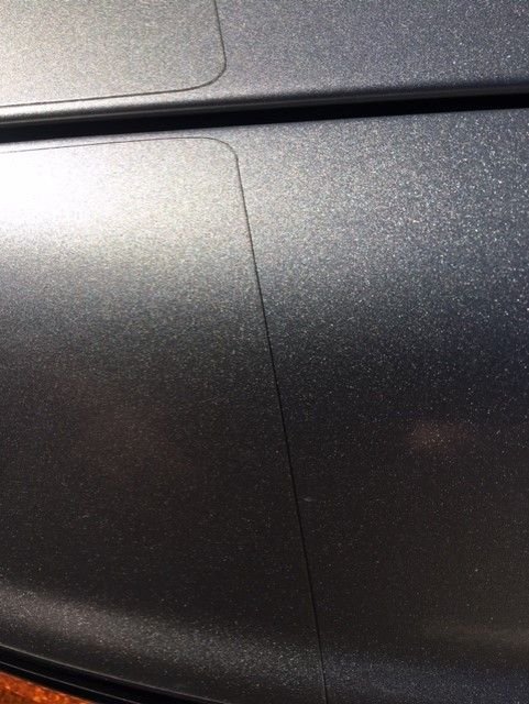

My 11 MDX 3M PPF partial 16 inches up hood cut before the seam done back in 2014. Very easy to spot. The film is still doing its job perfectly after +7 years.

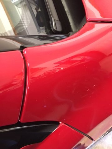

My 18 RLX with Xpel Ultimate covered bumper-to-bumper and tucked inside the seam. I have to tell folks there is PPF on the car or they don't notice it.

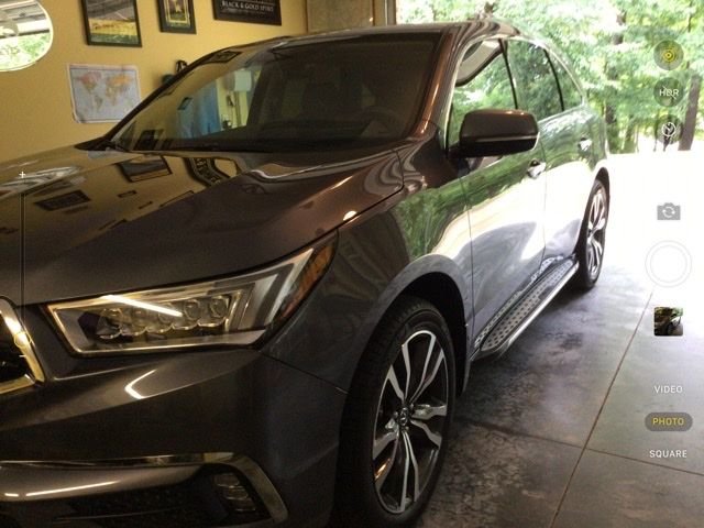

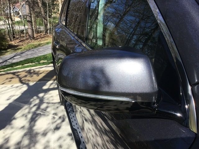

PPF ...... I purchased and applied a 3M Pro series partial hood, fender and side mirror ppf for under $100. True, it’s only a partial ppf, but it protects the front of the hood where the majority of road rash occurs ... and the entire side mirrors. The mirror ppf was a challenge to apply but the hood was not difficult and turned out well. You cannot see either (check out the barely visible line on pic of hood below) and I’m very happy with the protection. No hood or mirror chips so far with over 10k miles on the odometer and I do a bunch of hwy driving. I considered doing the bumper but I’m afraid it might be a bit out of my league. I may reconsider though.
Ceramic coating .... once the car was two months old, I gave it a good two bucket wash, ensured the surface was absolutely clean, then “waxed” the car with a hybrid ceramic spray coating made by turtle wax. $15 for a bottle. I give it a coat every 3-4 months after a thorough two bucket wash. The coating process (wax job) is very simple, takes 30 min. max for the entire painted surface of the MDX, including the wheels, and I will be able to get 4-5 applications per bottle, so over a years worth of shine and protection for $15. I used to use turtle wax ice but changed to their ceramic spray coating with my new 20 and am very happy with its performance so far.
I know this is not for everyone, especially the real diehard enthusiast, but I believe it’s a far better value and more cost effective when on a budget.

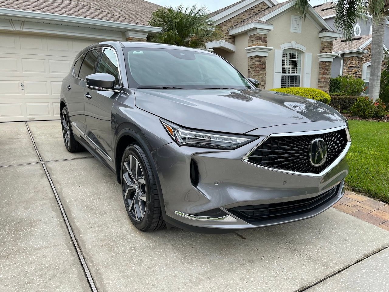

I do a lot of highway driving and my 2019 Pilot took a beating in just 2 years. Front bumper and front portion of the hood mainly, including two windshields. Lots of nicks and stone chips.
Just had PPF installed on the entire front end of my MDX. Also did the windshield with ExoShield. From my research - its well worth it if you do lots of highway driving.

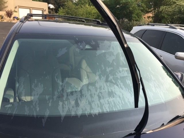

I did Exoshield on my 18 RLX and 19 MDX about 18 months ago. The film on my 19 MDX started to form blotches from wiper use when I traveled out of town for a week and it rain all day/every day back in June. Exoshield replaced for free and they said the formula was updated with the latest version of the film to help with this issue. The installer gave me some wax to use once a month on the windshield to help the RLX with the old film from doing the same thing. You might need to keep an eye on the Exoshield blotches if you get a lot of rain in your area.
We only got 5 inches of precipitation all year in NM. Zero blotches before the week long rainy trip in San Antonio and this is what it looked like when I got back.

Good to know. Thanks.
The PPF on the left/right front fenders did they wrap the seam by the door edge? My installer told me today it wasn’t possible to wrap this edge because the inside panel was “rough” and the PPF wouldn’t adhere long term. Does yours wrap around the edge or is it cut right at the edge?

I didn't go that far on the fender - just the front fender area where its part of the front bumper. Its cut and doesn't wrap.
But looking at the fender it does look like you could wrap it. It doesn't appear "rough" to me.

Yeah if you wrap around the back edge of the front fender at the seam that meets the door opening - its unfinished "rough". You have to open the door to see the back edge there.
Anyways - thanks for the input!!
