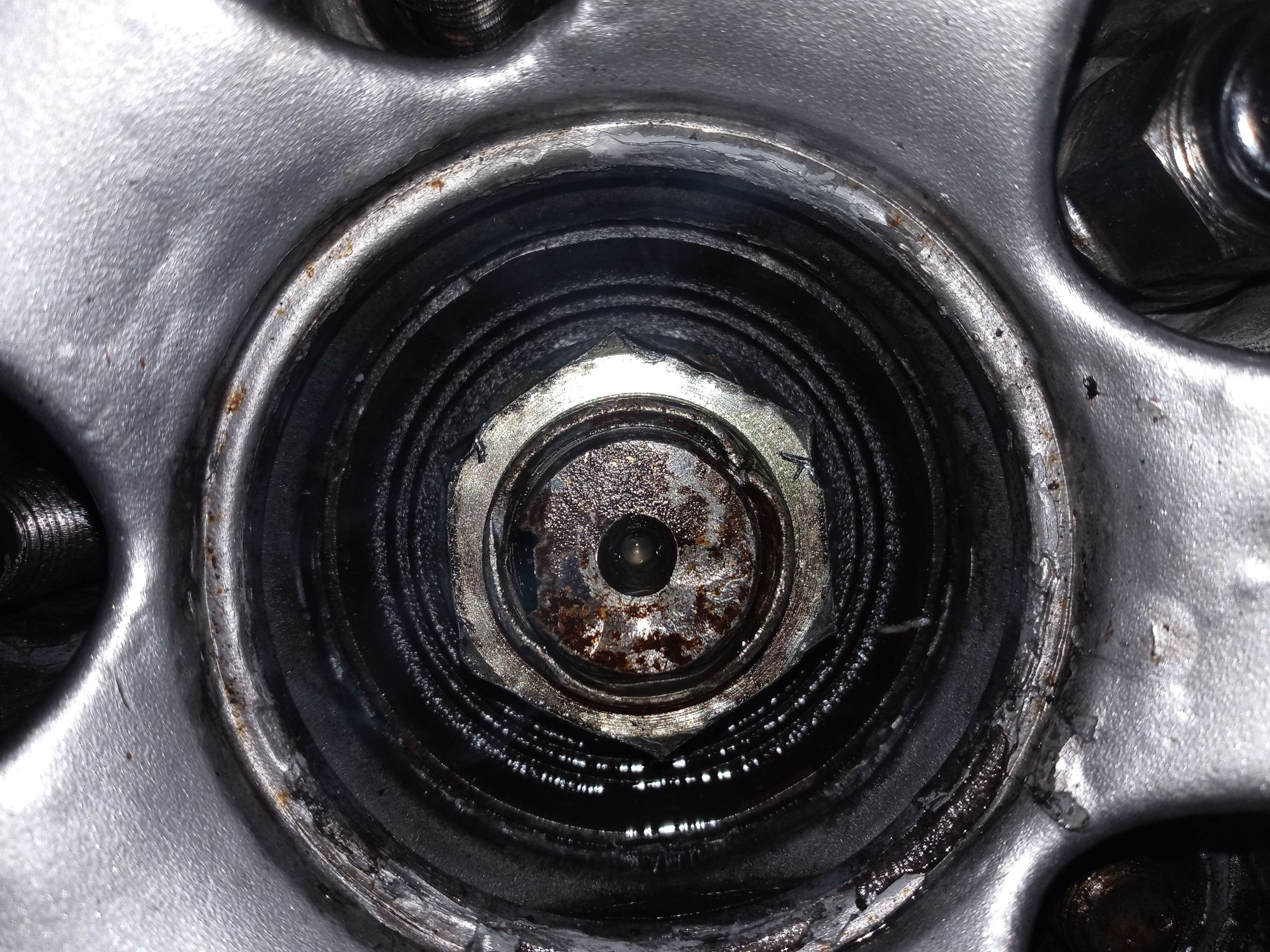

Mar 9, 2021 | 12:43 PM
Quote: I am having troubles getting off this damnn stubborn axle nut!
Silly question. Did you un-stake the axle nut, with a punch, at the place indicated by the yellow arrow?

Mar 9, 2021 | 08:12 PM
Quote: Ughhhh😩 thanks brother. Looks like I'll be getting a new one.
My advice; stop spending your hard earned $$ on expensive tools, when simple physics (read; cheap tools) works every time. As Archimedes said "give me a lever long enough and I shall move the world"
36mm axle nut socket + 1/2" breaker bar + 6ft length of schedule 40 pipe 1"dia will slip over the breaker bar. Even my measily 140lbs * 6ft = 840lb-ft of torque. This combo has worked for 99.9% of all bolts I come across (or I just snap the bolt or head off the breaker bar) other than my latest attempt for my axle nuts, funny enough.
Since heat expands metal.... 2 propane torches for 5-10mins, plus 6ft breaker bar = axle nut came right off.
Also, FWIW...... it looks like you've already spun the axle nut about 2/3 a revolution, based off the staked portion of the nut vs the cut-out in the axle, so it looks like SOMETHING you've been doing worked, at least a lil bit.

Mar 11, 2021 | 10:50 AM
Quote: My advice; stop spending your hard earned $$ on expensive tools, when simple physics (read; cheap tools) works every time. As Archimedes said "give me a lever long enough and I shall move the world"
Good....lord. The mess....
I think I'd rather just buy one tool than do anything that's going on in that photo lol.
Dont...heat up wheel bearings bruv. They have rubber seals that may now be no good.
Spend money on useful tools, I say, OP.
Not like you're only going to use a good impact ONE time. You're doing a clutch. Its gonna come in super handy a million other times.
I would buy a quality impact ONE time. I think you can find the Ingersoll IQV20 1/2" is like $350-400 sometimes.
Here...
https://www.ebay.com/itm/Ingersoll-Rand-IQv20-Series-Cordless-Impact-Wrench-Kit-20V-1-2in-Drive-/402656278177?_trksid=p2349624.m46890.l49292
If you just need to remove the axle nut...get a long 1/2" breaker bar. Pull up on it....you don't stand on stuff to get it loose, that's bad practice. You'll strip the head of the nut trying to stand on it since it'll keep wanting to slip off.
