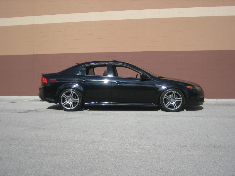

COILOVER TYPE: I
FRONT
CtC Spacing - 4-5/8"
Wheel Gap - 1 finger (25-3/8 wheel well arch to ground)
Damper Clicks - N/A
REAR
CtC Spacing: 4-3/4"
Wheel Gap: 1.5 fingers (25-7/8 wheel well arch to ground)
Damper Clicks - N/A
RIDE QUALITY - Definately stiffer than A-Spec Suspension but not harsh.

That looks effing perfect, IMHO.

I might drop the front another 1/8" - 1/4" just to plant down that front end a bit more and make the rake a bit more dramatic. Not sure yet either way.

I agree. Its not "dumped" and not 4x4. Looks sporty as if that is how it was suppose to come.

COILOVER TYPE: I
FRONT
CtC Spacing - IDK Never Measured but will soon and Let yall know
Wheel Gap - No Finger Gaps, To low to have any
Damper Clicks - N/A
REAR
CtC Spacing: IDK Never Measured but will soon and Let yall know
Wheel Gap: No Finger Gaps, To low to have any
Damper Clicks - N/A
RIDE QUALITY - Ride is Stiffer which was expected but not to bad to make me hate it. I like a Sporty ride quality so I have no problems with it even with 20s on. They just rub a little but I'm getting that fixed soon
http://www.flickr.com/photos/tl-s/5821659945/
