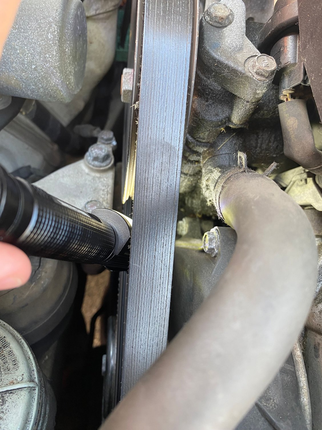

What is this leaking behind the serpentine belt?
Old Jun 24, 2025 | 04:32 PM
weloveacura's Avatar
Joined: Jun 2025
Posts: 19

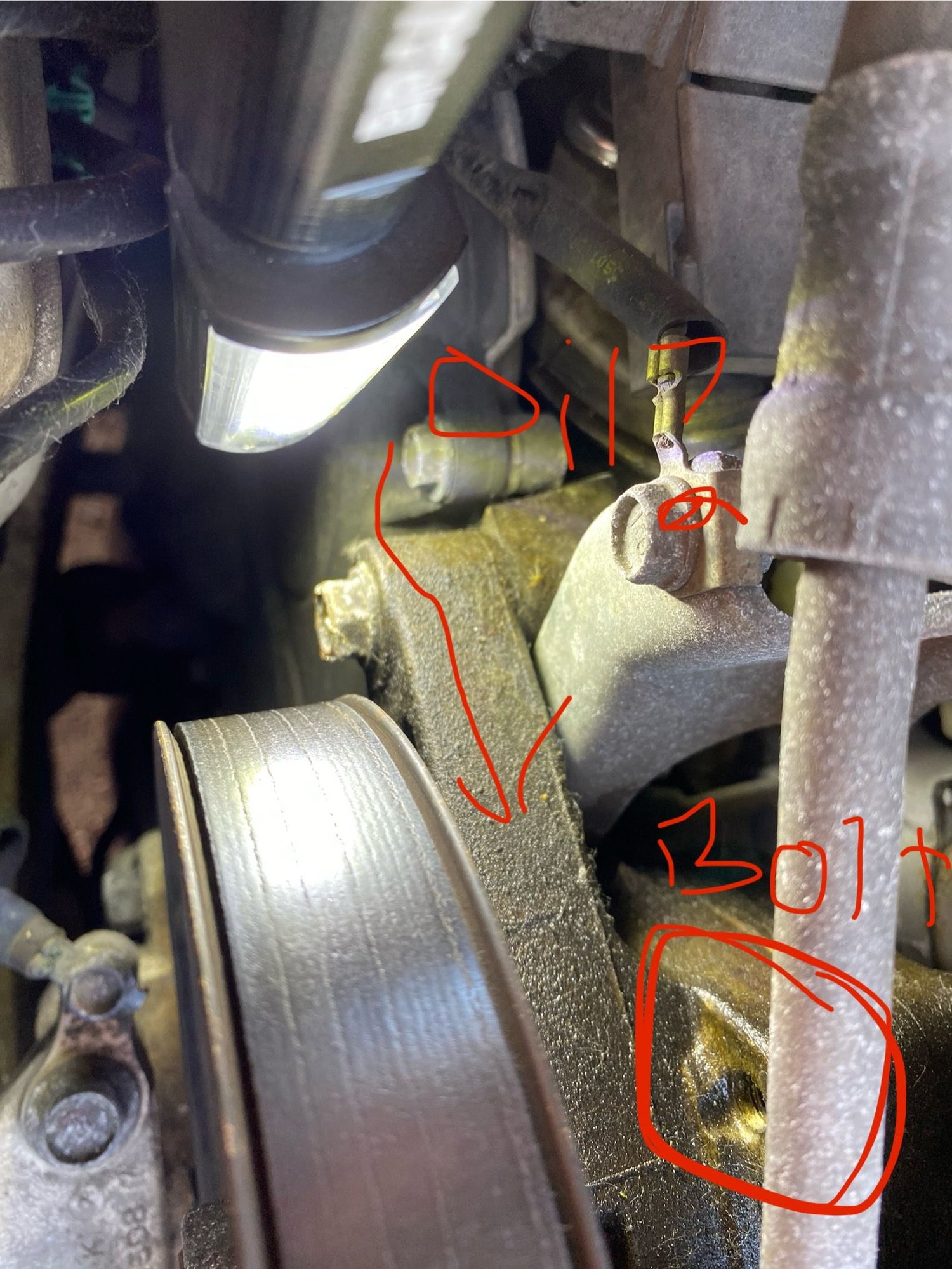

Behind the top left pulley, not sure what it is even for. Oil? everywhere, leaks down onto the belt below.
Looks to be a bolt missing? Culprit? Or replace whatever it is
Thanks

Power steering pump?
Old Jun 24, 2025 | 04:46 PM
Posts: 48,311
that'd be your power steering pump, very common leak
Old Jun 24, 2025 | 04:58 PM
Joined: Jun 2025
Posts: 19
Thanks man, should I replace right away? It’s been leaking probably over a year. Got this car 6 months ago.
The belt squeaks a bit on cold start, now assuming it’s because of the PS leak. Fluid level looks fine. Only added a little one time.
You can take off the pump and replace the o-ring that goes bad on that plastic black elbow where the hose attaches, same with the upper hose on the pump that can cause issues. The kit is like $10 at auto parts store.
