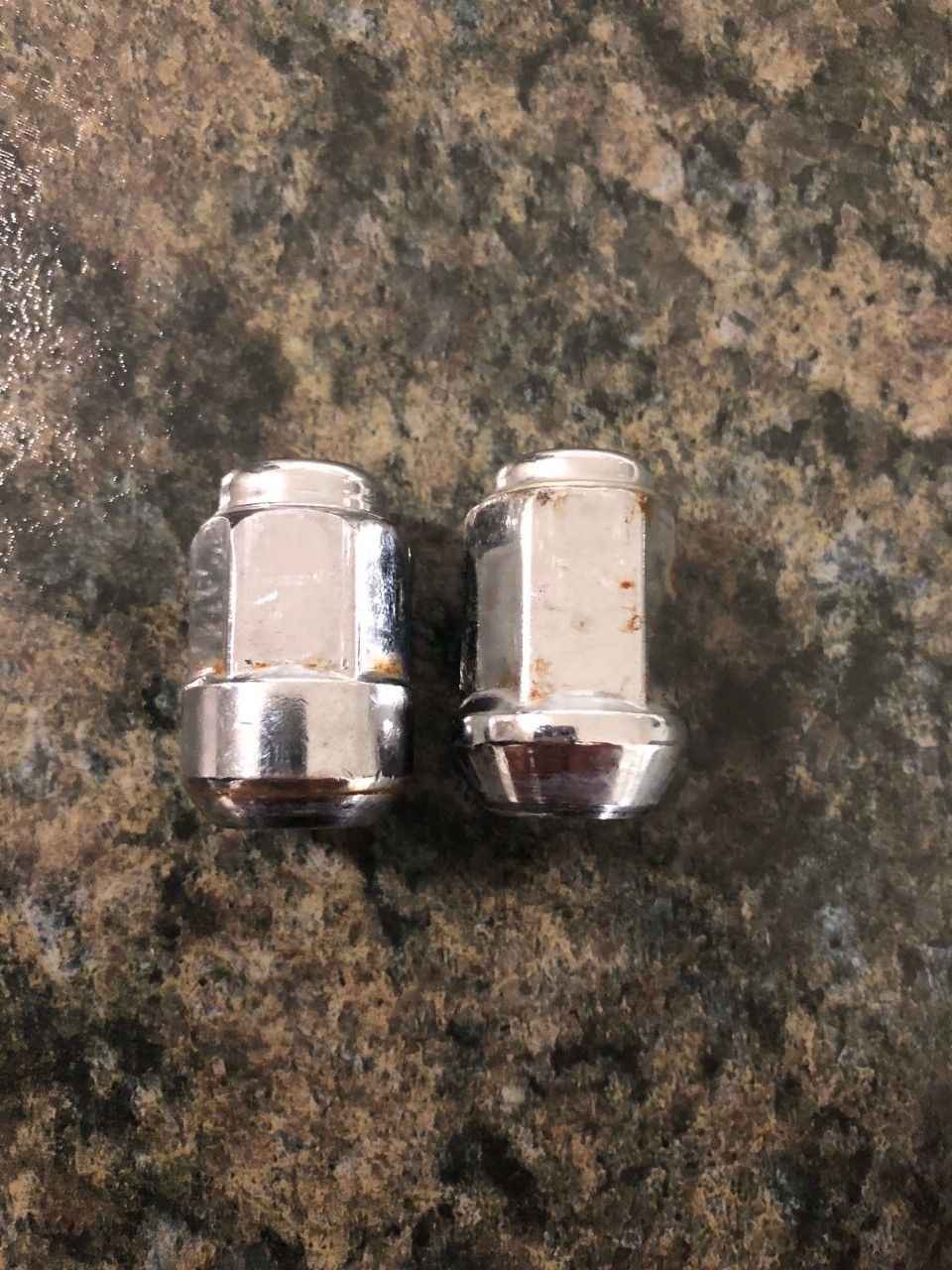

So I just got back from Discount Tire and received some bad news. The service manager told me that my rims are shot. What what?! He said that it looks like a few OEM lugs were used instead of the aftermarket conical lugs, which caused the circle openings on the rims to strip away.
I just checked myself and sure enough, he was right (OEM on left, Aftermarket 60 degree on right)
Crap... I didn't even notice that I mixed them up. Discount Tire wouldn't even proceed to work on the wheels at all because the damaged rims void any and all work performed. I switched 6 OEM lugs with the correct Aftermarket lugs and the wobbling still remains. I have 1 OEM lug on each of my rear wheels for the time being, because I don't have any more Aftermarket lugs right now.

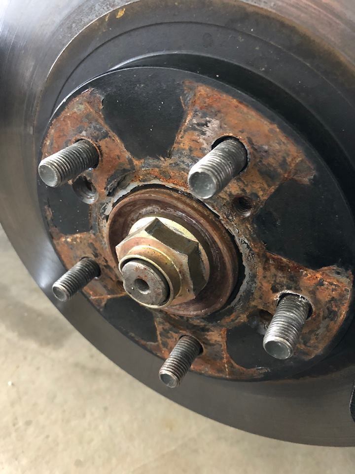

Alright, here are a few pictures of the lug studs. I just took off my front two wheels for a quick analysis. From what I can see, the studs look to be okay. I don't see any stripping or worn down threads.
Front Driver's Side
Front Passenger's Side

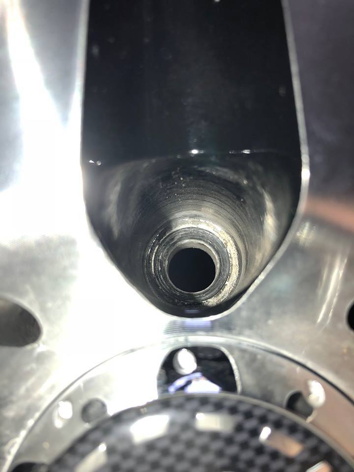

Here are a few pictures of the rims. It's very hard for me to determine if the rims are ruined, because all holes look the same.. Like I said, I had a few OEM lugs on each rim. I do not recall which holes they were, but I've taken my rims off a few times. It's very likely that the OEM lugs made their way around to each hole.
Lastly, I can't believe I didn't see this before, but I noticed the PSI on my driver's side rear tire was low. Lo and behold, it looks like I ran over nail like csmeance suggested. I can almost guarantee that's the reason for the "whoop whoop whoop" sounds.
