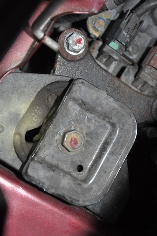

The only thing I noticed was the thin rubber "dust cover" that's on the transmission mount is torn - it's real thin rubber that probably just dried and cracked. But could that be a sign that the tranny mount may be cracked underneath?
I did some poking around just now to see if I could see or shake anything or knock on things to reproduce the sound.
