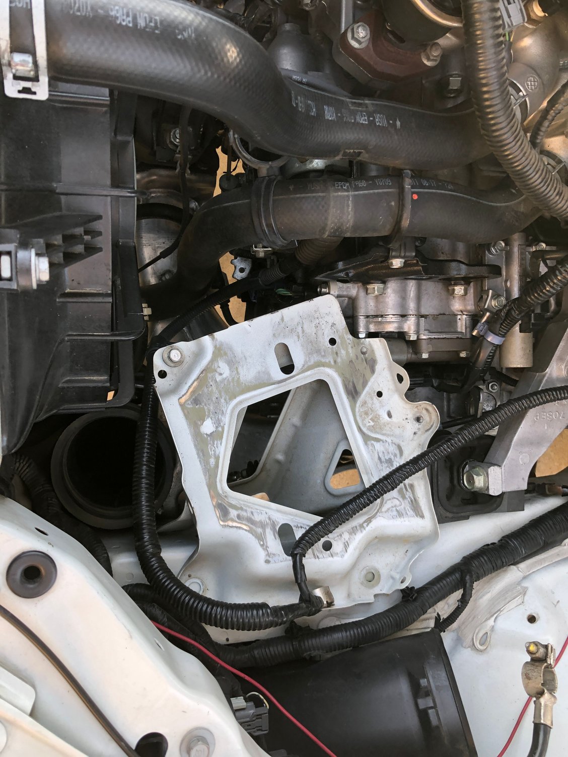

You don’t really need to remove the tray, just the plastic battery box. The mounting bolts and electrical connections are reachable from the top of the engine bay. That being said, you might have to disconnect the coolant lines to remove the starter IF you don’t remove the battery tray.
the tray isn’t difficult to remove, just kind of awkward to get to the bolts on the underside.

Starter
That pic shows the battery tray canted forward. Mine is pointed directly to the passenger side. I don’t think there is enough clearance to remove the starter, even if I could get at the mounting bolts.

Remove the metal tray? IIRMC, it is only a few bolts. Problem solved.

i agree, remove the metal try, it will make the job easy also i remember correctly, you don't have to remove the bolt, just lose it and the try will slide up.

My friend, a mechanic with knowledge and more importantly tools, replaced the starter the other day. He said he had to use some long extensions to remove the bolts at the bottom of the tray.
