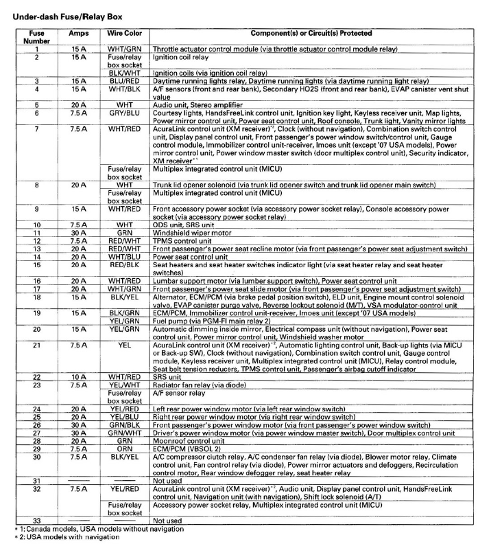

Check fuse #7 in the under dash fuse box.
Whats fuse 7 for anyways ?
Old Oct 10, 2016 | 11:07 AM
peter6's Avatar
Joined: Apr 2016
Posts: 1,554
Likes: 498
"Security indicator"

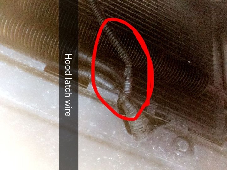

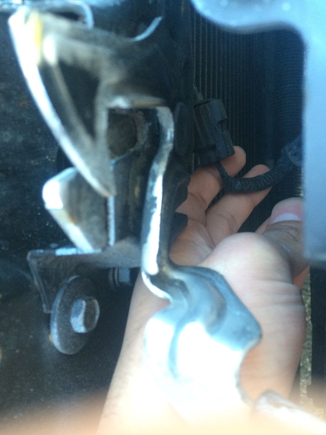

and I'm out side and the wire traces down near a whole where all these other wires are swell but there all covered

Hood latch wire

Originally Posted by 2008.Tl
Hood latch wire
Disconnect that connector and test it for continuity on the latch side of the connector. You should have continuity with the hood open (latch released) and no continuity with the latch pushed down (hood closed).
