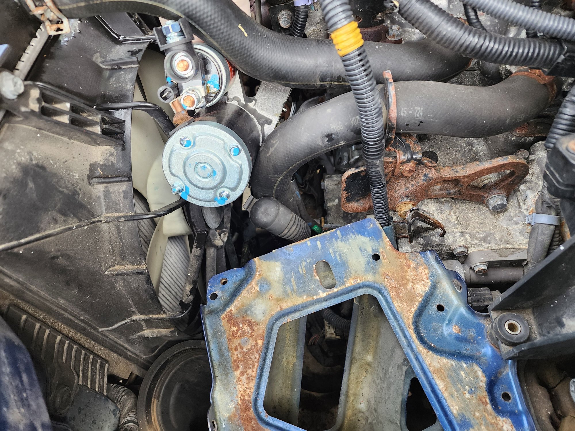

I have searched and haven't found any recommendations to replace the 3G TL Starter without removing the battery tray.
I was able to replace the Starter with the Tray still in place. This may have been discussed before but it was nothing I could find.
pics:
This is the new Starter. Access to Starter is easy with tray in place.
Tray still in place

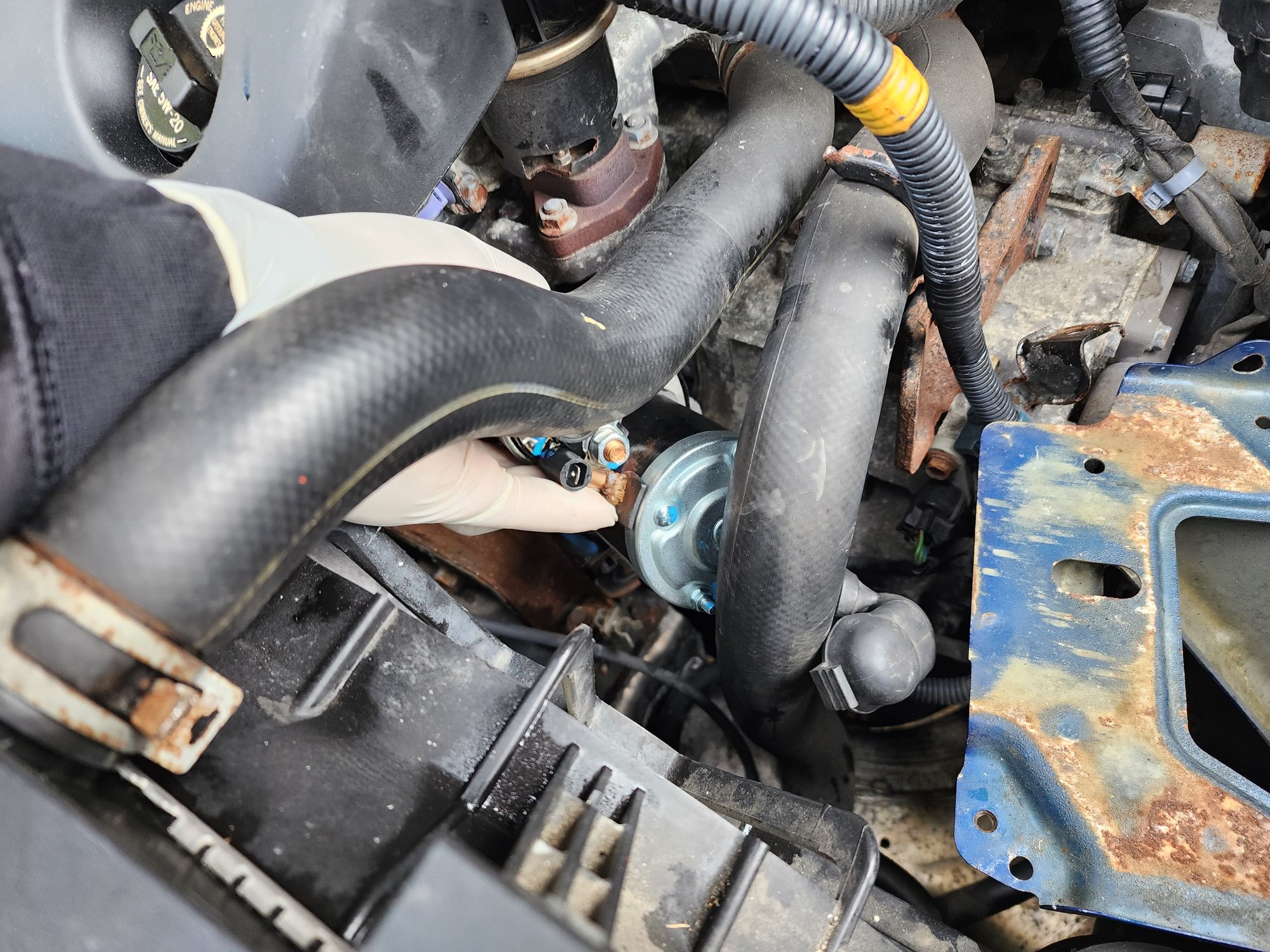

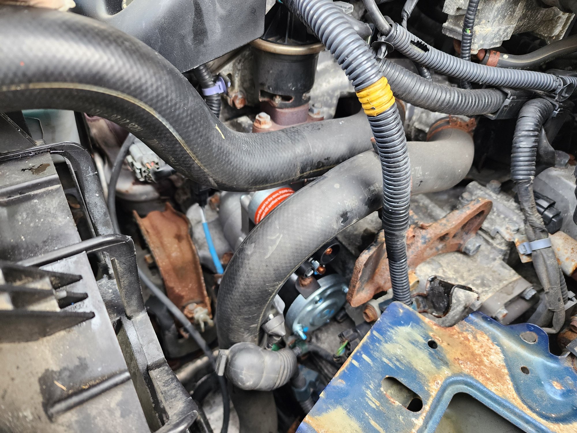

Sliding in between hoses

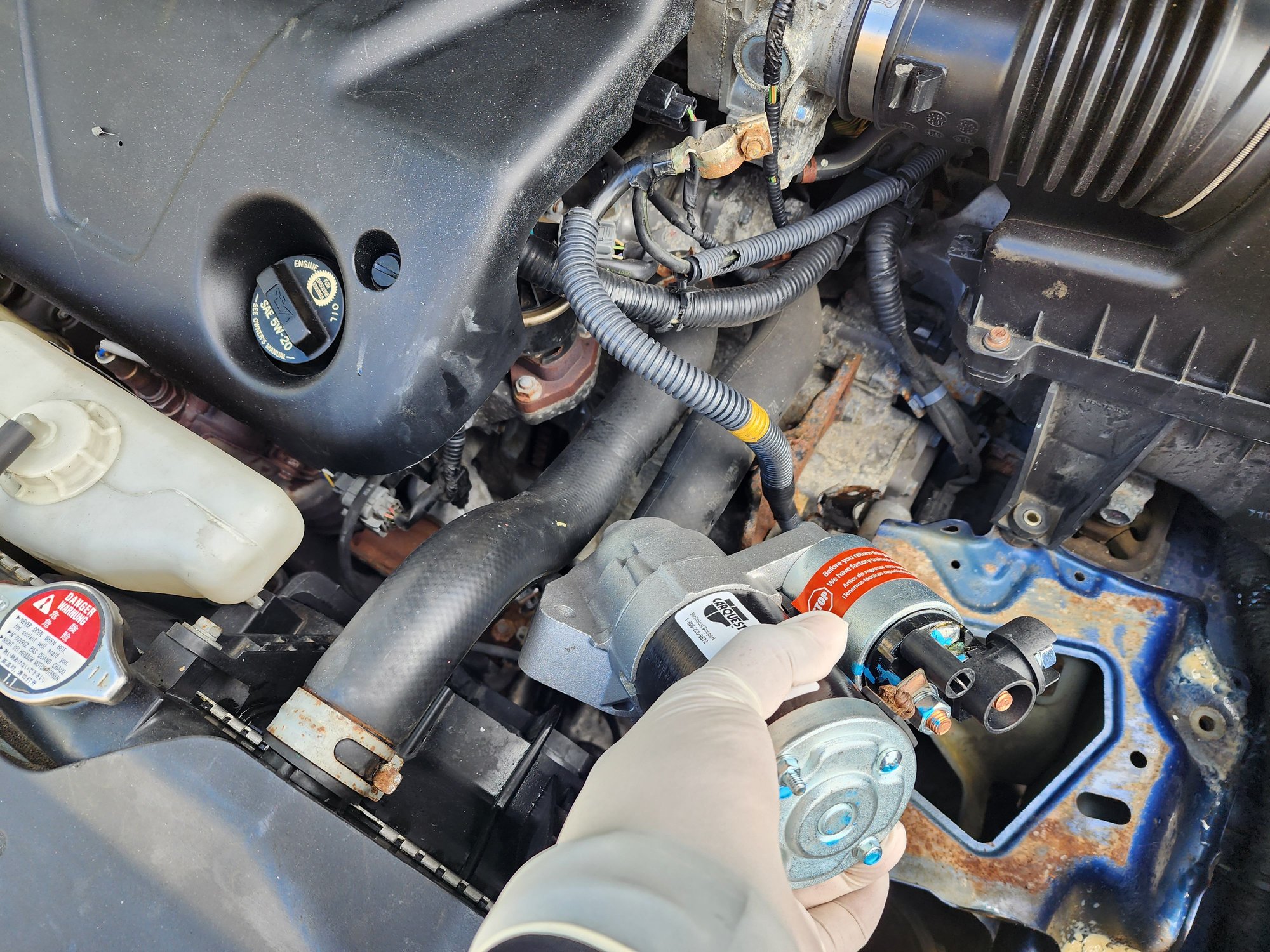

Comes out at this angle and begin re-install in the way.

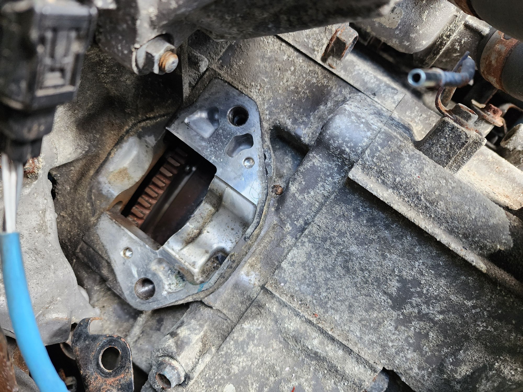

Inspect gasket before reinstalling
Cleaned around area for dirt and rust.

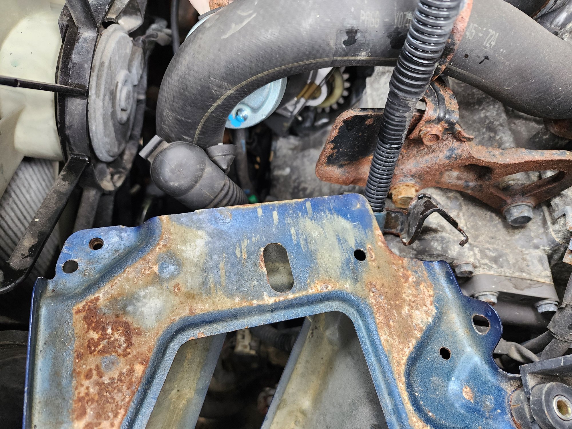

Nestled back in and ready to bolt up
