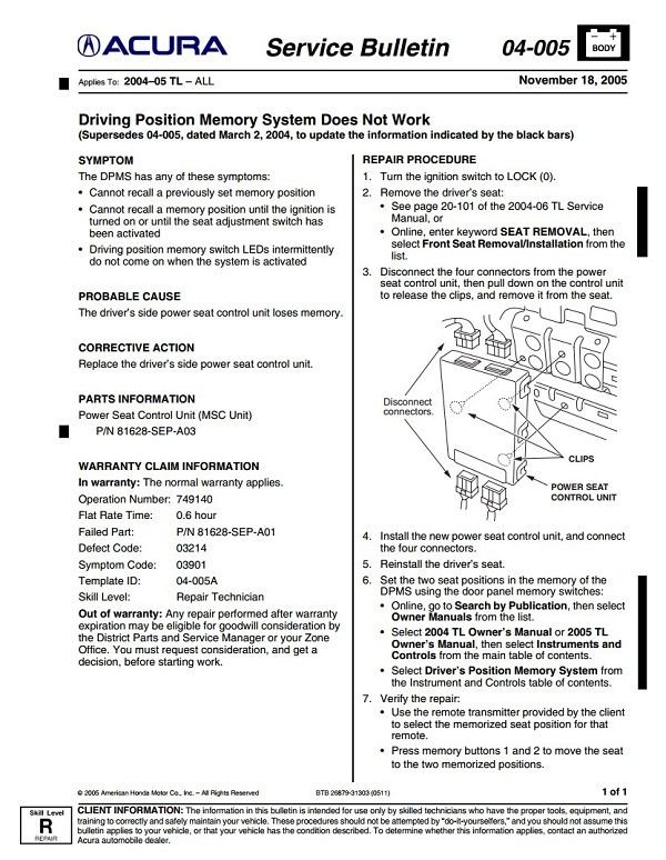

Thanks Will. Actually, the mirrors and the seats move. However, my next problem to fix is the seat memory. I am unable to save new seat memory settings. Very annoying, as every time I get in the car,
the seats reset to their old settings, and I have to adjust them.

You need a new model seat module. The part number is 81628-SEP-A03.

might be a bad mirror actuator, that will usually cause the memory seating to disable so the memory seating led won't light up and the buttons won't beep. if you're having mirror stuttering as well, especially when they drop down in reverse, the actuator may be the issue. Sometimes it helps to just open them up and clean them and apply new grease. After that, cycle the mirrors up, down, left, right, etc and it should all work.

Thanks for the info. Yes, my mirrors do stutter in reverse. I'll give it a shot and report back.

I cycled the mirrors up/down/left/right after which the seat memory keys started working again. Thanks a bunch!
