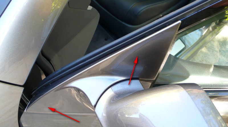

In the meantime, I followed your advice above and played around with the door/window area while stationary. What i noticed was that the size mirror is VERY creaky! I could easily make a whole lot of noise by flexing the mirror only slightly - so this may be a factor also. Has anyone experimented with silencing the mirror?

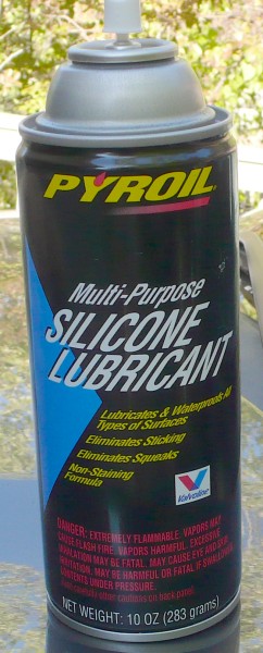

While still waiting for the stethoscope, and without having applied the Gummi Pflege, I decided to attack the outside mirror. First of all, this is where I hear the loud creaking:
When I press on the two points indicated, especially the lower one, I hear a very pronounced creak. So I sprayed silicone under / behind the rubber
I went for a pretty lengthy test drive and did not hear one sound from the window - not even descending the steep and bumpy road outside my house, over which any creaks and rattles are excused!
Here's the product I used, simply because I had it in my garage from prior jobs; hope this is an appropriate product!
I will see how this sounds for a few days before applying the gummi pflege!

A week after the fix above and the window is SILENT! I'm so pleased!
The sound seemed to be coming from the top, rear, or bottom of the window, but all along it was coming from the outside mirror!
I still plan to Gummi Pflege the rubber, and also to silicone spray some of the interior trim, but I'll wait until a rattle returns.
By the way, in the picture above, I show the spray nozzle under the rubber; in reality, I lifted up the rubber trim, and sprayed heavily in the area. A lot of the liquid ran down the outer side of the door, but wiped off ok.
