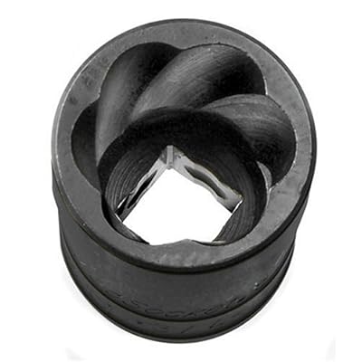

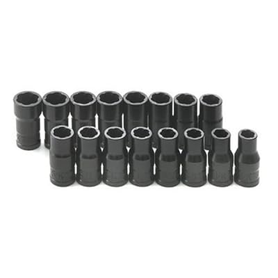

This is old. I have removed my airbag probably another 4x since this thread. I realized since new ones only cost a few cents, I am not going to waste time trying to save them from stripping. I got a set of turbo sockets.. Yes 1/4 turbo sockets.
http://www.amazon.com/SK-756-4-Inch-.../dp/B0007GGUE2
What you do is tap the sockets to anything stripped or rounded, in this case use them on the airbag torx screws. While using a small extension and 1/4 rachet they come off. Now Don't even bother trying to reuse them just change them. In some cases you can get away without using them but I don't even bother anymore just tap them on and spin them off your done. No more messing around.

wow.. im 90% done with my non navi to navi install and encountered this problem.. any other way to get these suckers out without having to wait to get that turbo thing? Did the acura tech lend you the tool to remove it? If so what was it? I need my car back together by Thursday, so I need something to remove this stripped torx screw by tomorrow..
thanks!
Old Oct 7, 2009 | 01:58 AM
bzyrice's Avatar
iTrader: (10)
Joined: Jan 2007
Posts: 2,221
Likes: 21
Actually just found out that sears sells a craftsman version of that turbo tool.. hopefully they have it in stock when i go there tomorrow! So I can finish my navi conversion..
