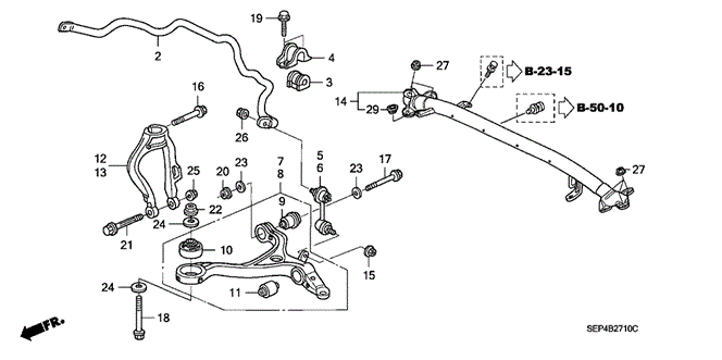

^^^ SO how is it save you roughly $500 again?
https://www.oemacuraparts.com/auto-p...lower-arm-scat
Part #10 cost $23.37 x 2 = $46.74 and by the time it shipped probably be around $50. I paid my local Acura dealer $481 for labor and that with a four wheel alignment included. I am kinda confuse about saving $500 for going aftermarket route in reality you actually spend more than going OEM route on a part that know fail quite quickly.

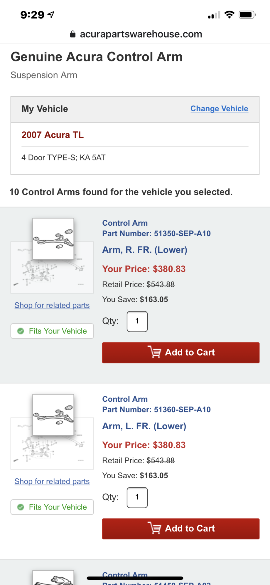

Hello sorry to bring this back from the dead ...
im in need of lower control arm! There has to be a cheaper place!!

As discussed above, if you need new arms because bushings are worn out, then replace just the bushings.
Otherwise, that's the price for OEM arms.
