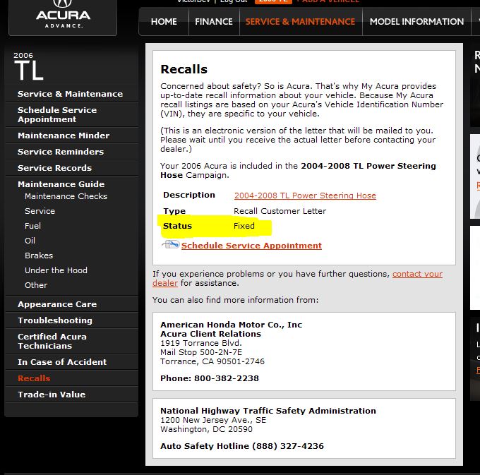

Attaching picture of MyAcura web site with recall info:
Does this mean power steering recall was done with my car?

supposedly YES

Thanks. I am second owner, and wasn't sure recall was performed on my TL.
