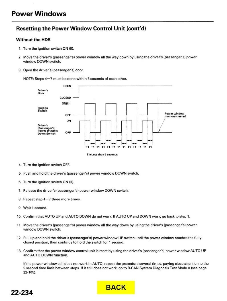

4 and 5. There is procedure to reset auto window feature without scan tool. Try that:

2. Automatic windows might stop working because battery is going flat, resetting the module. Don't worry about that for now.
