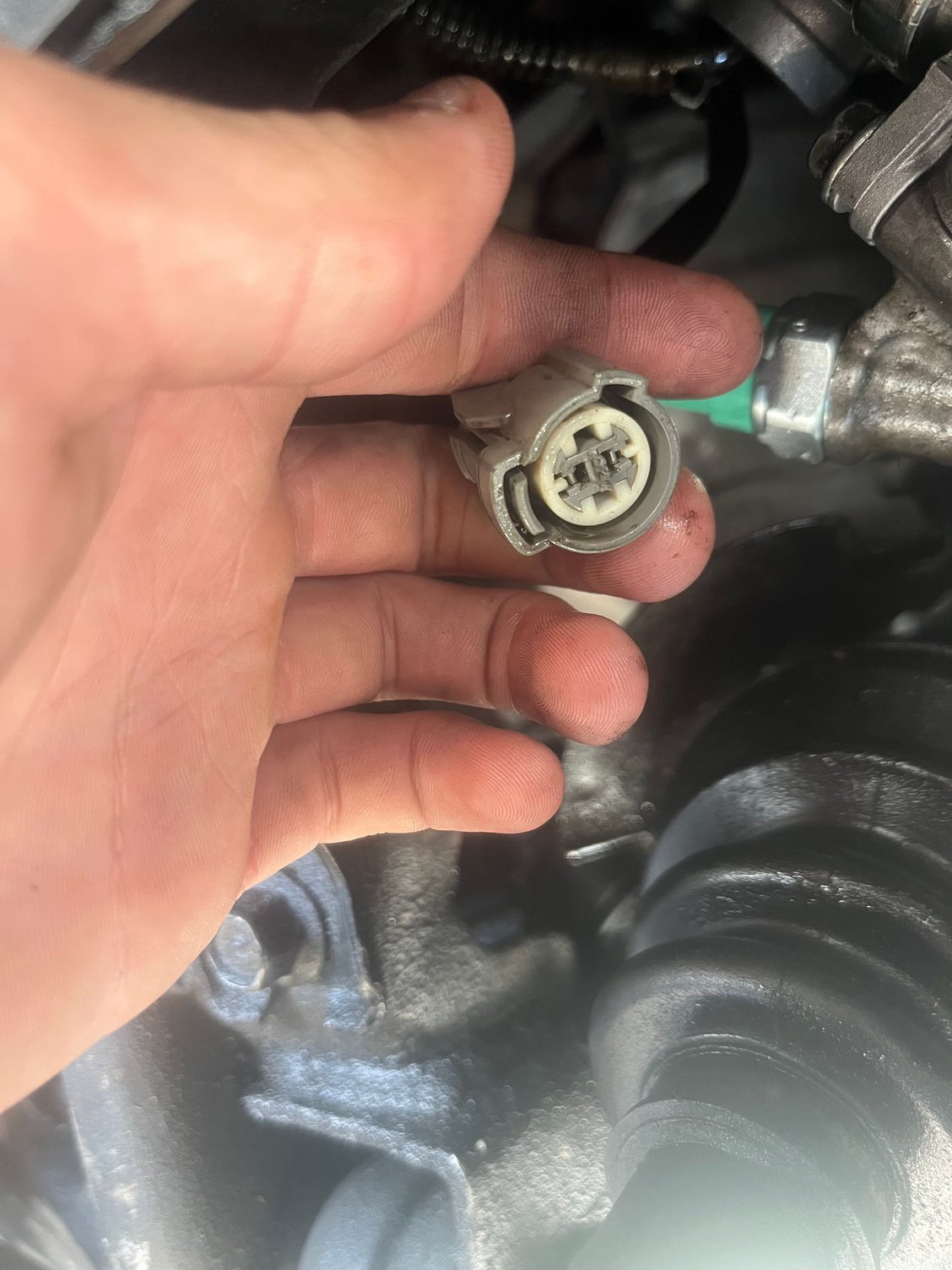

I don’t think it’s possible that all my speed sensors and abs went bad at the same time after not being able to go further than 3500 rpm’s. But I checked my grounds all are good. On the other hand.
Does this connector look normal?

Is that the power steering pressure switch connector or the 4th gear transmission switch connector, and what do you mean by "normal?"
