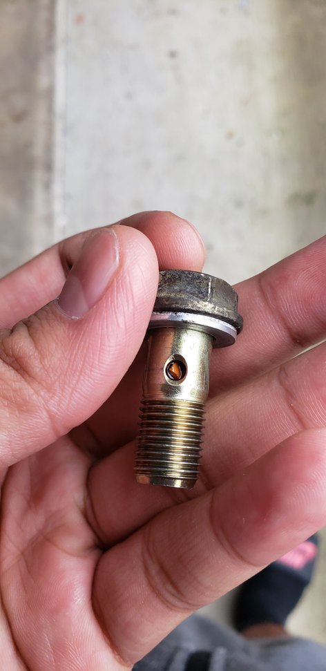

I bought my Acura TL knowing that this code was an issue and thought that the TCC solenoids were the issue. After replacing the top two solenoids and replacing the transmission filter and fluid I cleared the code and drove around. After driving for about half an hour I plugged in my scanner and found the P0741 code as pending and after driving some more it become a stored code. The engine light isn't on and the car drives fine. When I removed the screw for the transmission filter I found some plastic clogging up one of the fluid passage ways and cleaned it out.
Could it be a wiring issue? The other two solenoids? Plz help

I forgot to add that I checked the ohms for the 4 different solenoids (2 on top and 2 below the starter) and they all came within spec, 12-25 ohms while mine were between 14.8-16 ohms. While replacing the transmission filter I removed plastic clogging the passage way in the screw.

After draining the fluids and changing the filters and reseting the car, it runs fine now with no code
