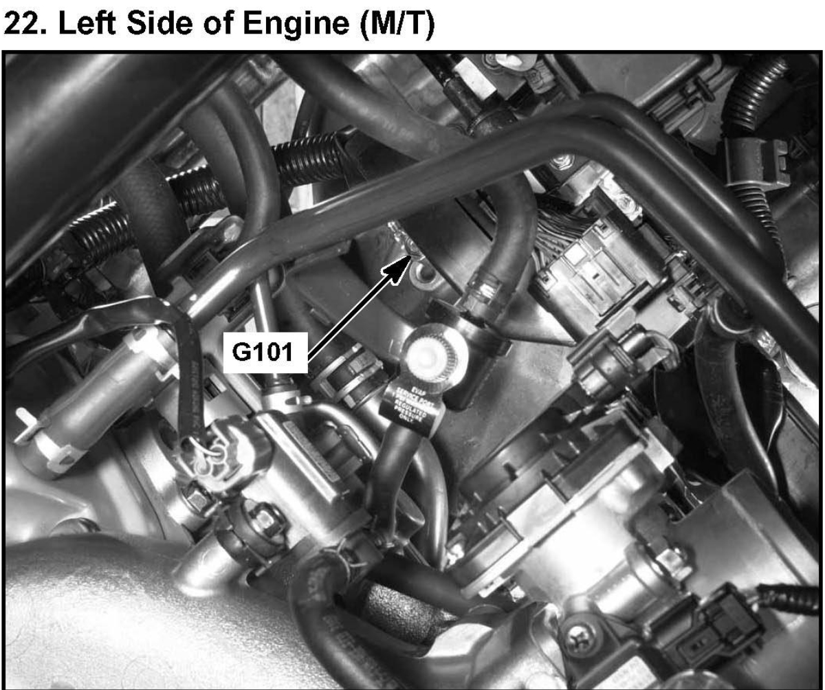

- Brown/yellow should be ground. Schematic tells me that ground is on "left side of engine" Test ground with test lights (like 1A of current) to the battery terminal.
P0389 is for crankshaft position sensor.
The only thing that they share are power and ground. That lets me believe one of those is your problem. Power (yellow black) is feed through "PGM-FI main relay 1". But I would check that ground, as it's common with both sensors and most likely was touched when changing the motor.
That's your suspect ground location:
There's a part of throttle body one the picture, so it should be easy to find. Evap service port and evap purge valve are also a nice clues.

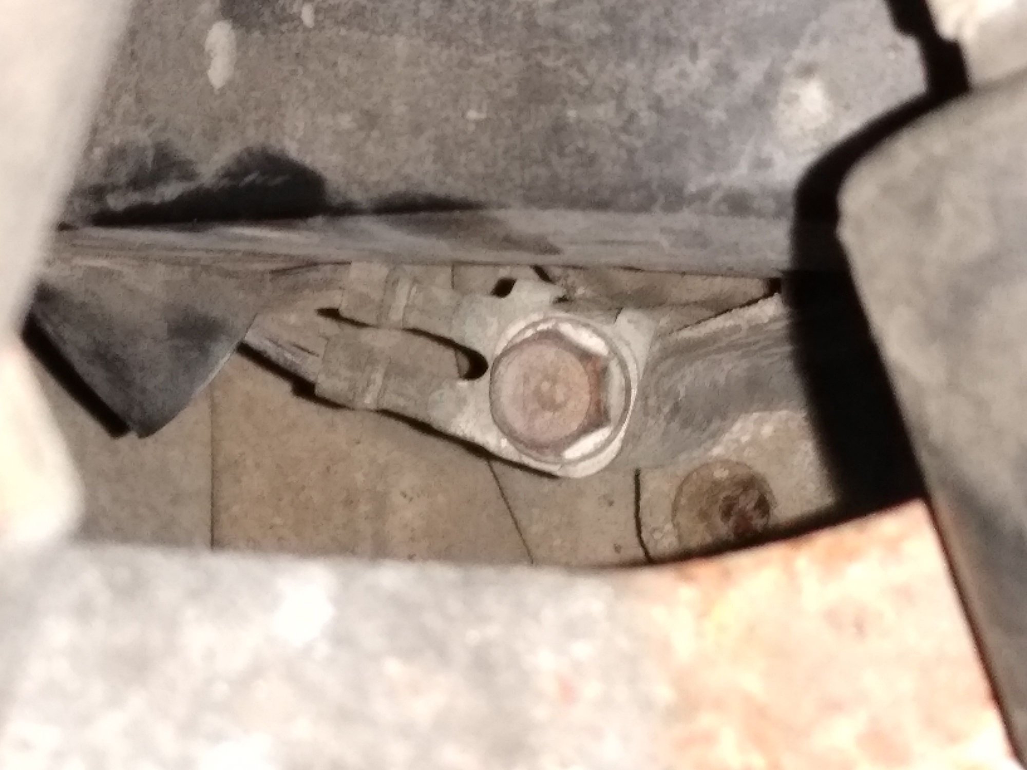

The ground looks perfectly fine

You sure that it's good?
Then go back to testing directly at the sensor. Must be a reason why it's not working. Check out that relay, but it's unusual for relays to go bad while latched (to cause car to stall).
