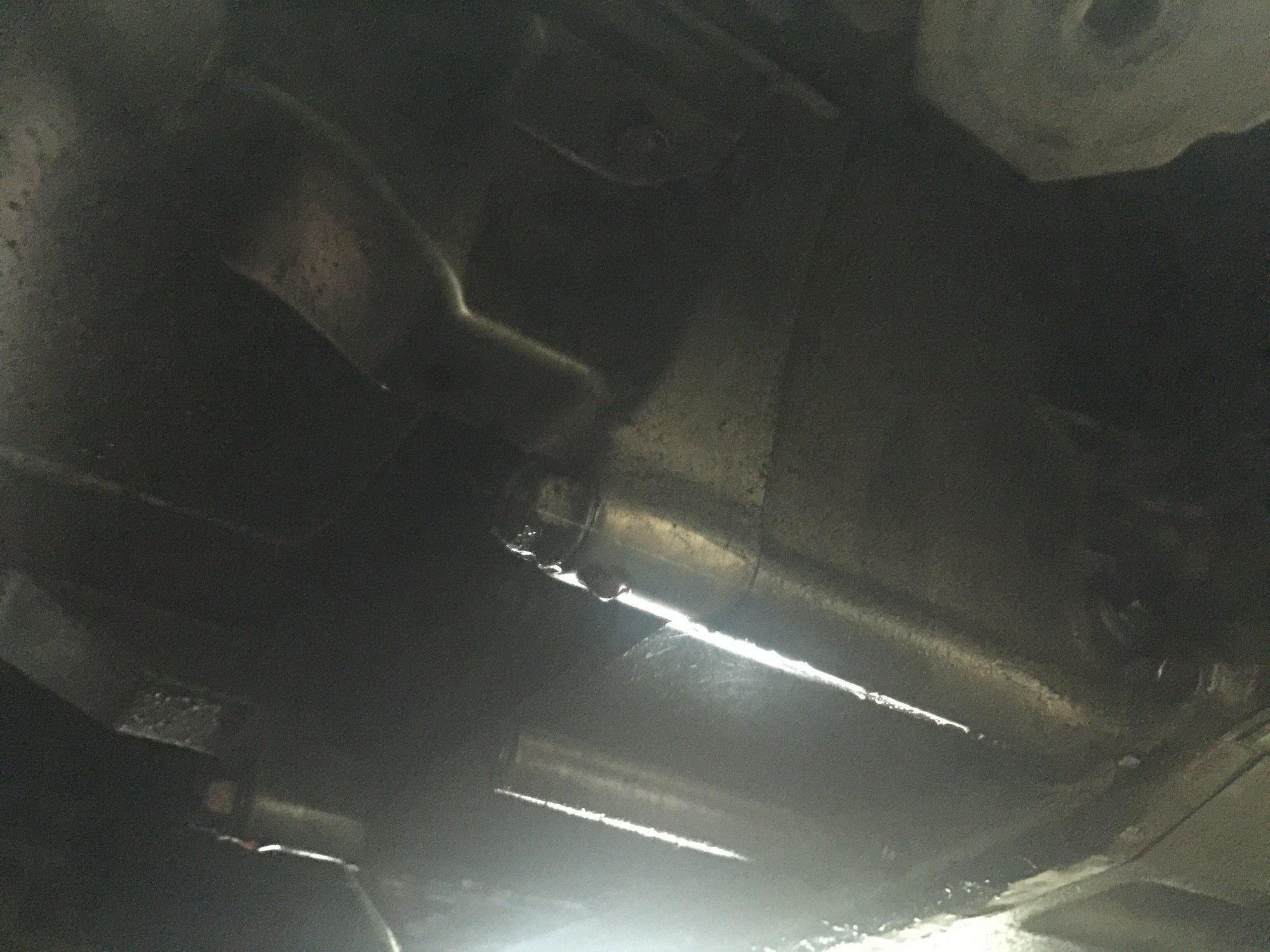

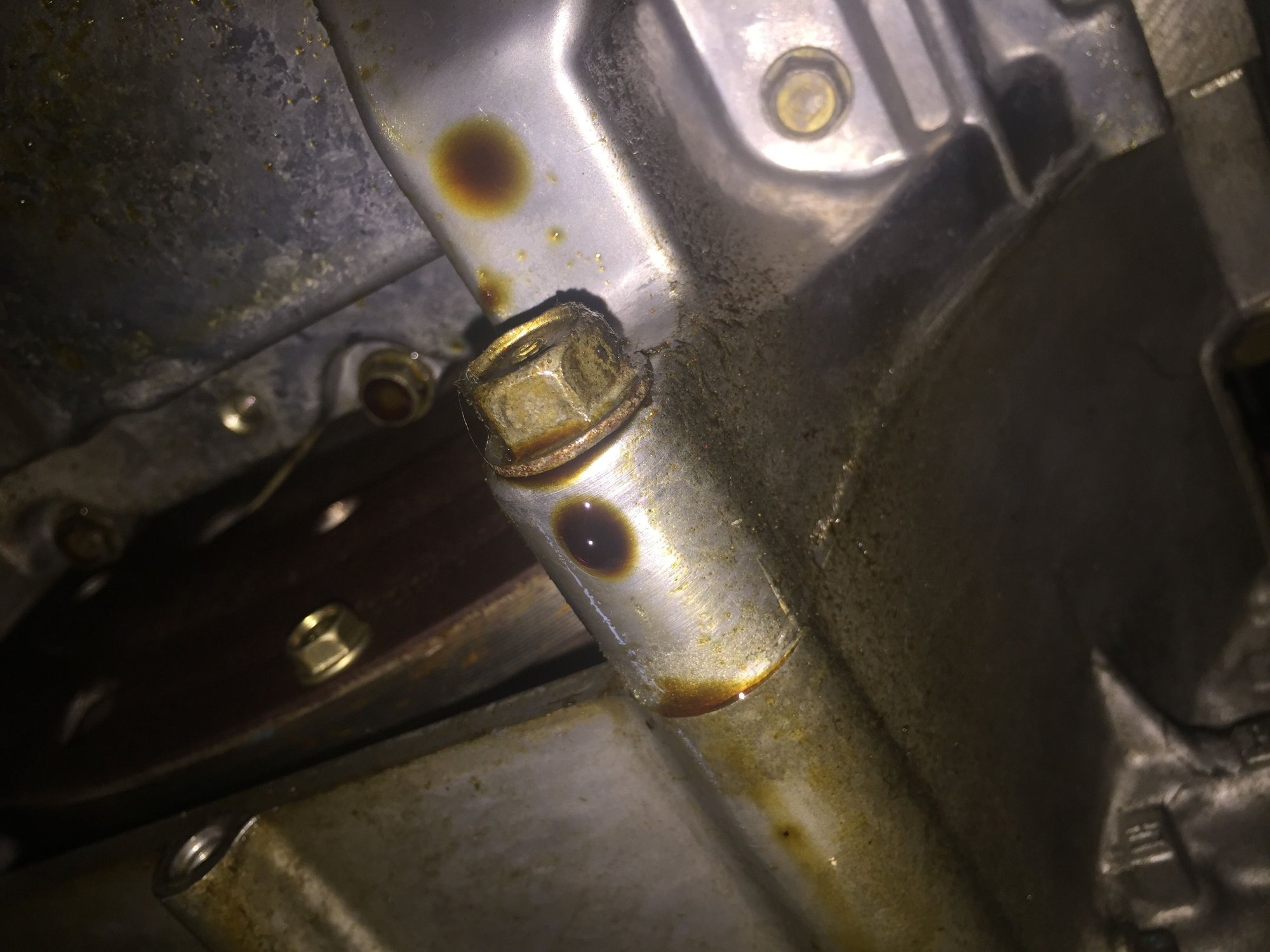

Alright guys, I've had an oil leak in my car for a couple years now, and I have absolutely no idea what it could be. I've had my oil pan fixed TWICE (I'm not even lowered) and I've also changed my pcv valve. I still have a bad oil leak. I went under my car today to find this. There's also multiple oil spots in my garage that are pretty big. Anybody know what else I can check?

looks like rear main seal. Is the leak in between the block and the transmission housing?

rear main seal, its a $9 part but cost $900 for labor.

900 bucks!? I'm pissed that I've spent the money to fix things that aren't even the problem. The shop has never once brought up the rear main seal, but i bet you that's what it is. You're right flyromeo its in between the block and transmission housing

If it is indeed a rear main seal leak and it's been ongoing for 2 years now, you're going to have to get it replaced if you want the leak stopped. Sometimes rear main seal leaks stop as suddenly as they started, but that doesn't appear to be the case here.
On the other hand, you can add a lot of oil before even reaching 1/10 the cost of having it replaced. Do you have to add oil between oil changes? It's hard to tell for sure from pictures, but I'm not sure I'd wait much longer to get it replaced.
Have you tried taking it to a car wash and completely clean the areas with a degreaser and then do a follow up check?
And yes, it's a $9 part and the labor should be ~$900. If they try to charge you more than that, go somewhere else.
