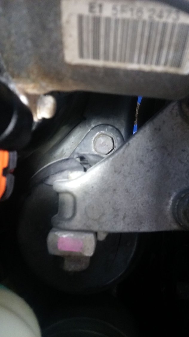

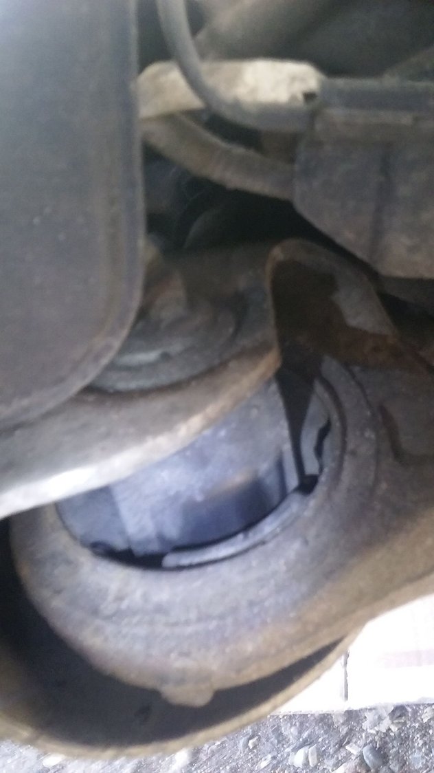

Recently my 05 base Tl with 114k miles developed a knock/clunk from front end. It usually occurs when driving in a parking lot at low speed and hitting bumps on uneven pavement. It's not very loud most of the time but I can feel it in the steering wheel and certain times, but particularly if I hit a bump while the wheels are turned (such as entering a driveway) it is louder. I got under the car and checked inner and outer tie rod joints, upper/lower joints on steering knuckles, sway bar end links, motor mounts all bushings and axle joints. Everything checked out fine to me except the following.
Below are photos of the problems I found. The control arm bushings have tears on both sides which I know is typical of these cars but it doesn't look nearly bad enough to cause metal on metal contact, the passenger side motor mount under the hood has a torn rubber boot but I don't see why that matters as the metal brace itself is solid. By far the biggest issue is my front passenger side strut is completely shot. Strut fluid is running down backside and onto control arm and axle. It's completely soaked but I've never heard of this causing a clunking noise. Obviously these all need to be addressed but I'm hoping you guys can help me narrow down the clunk.

It could be any of the 3 items you show- they can all make a bang or thump. Definitely need to replace the control arm compiance bushings and the struts. The side engine mount is probably also broken. That is easy to replace. The struts can be purchased as a whole assembly (including coils) and replaced. Check on acura Oem parts website or with Acura of Augusta

bad front compliance bushings cause loose steering feeling, bad shock will cause that clunking noise. The side mount is easy to replace, acuraoemparts.com and use acurazine for 5% off.
The front compliance bushings can be changed at home or you can pay the dealer/independent shop to do them.
I'd honestly buy 2 new shocks and replace both the front shocks. That way you won't run into issues and you can do everything at once. I'd highly recommend Koni Yellows as they have a lifetime warranty. A member was selling 4 used ones here for around 300 in the black market section.

I'm planning on doing all 4 struts and bushings soon. Is there a way to verify that the motor mount is bad because I don't understand how cracked plastic cover makes it unstable? When I removed it to do 105k maintenence it seemed fine. Also I haven't been able to find complete strut/coil assembly ANYWHERE!!! Not on acuraoemparts.com that I could find and my local dealer can't even get them. Because of this I'm considering doing aftermarket performance coilovers because I'm not equipped to remove the coil from strut. I'm OK with stiffening the ride a little but I don't want it to drive like a rice racer... Does anyone have any recommendations for coilovers that won't completely sacrifice ride quality?
