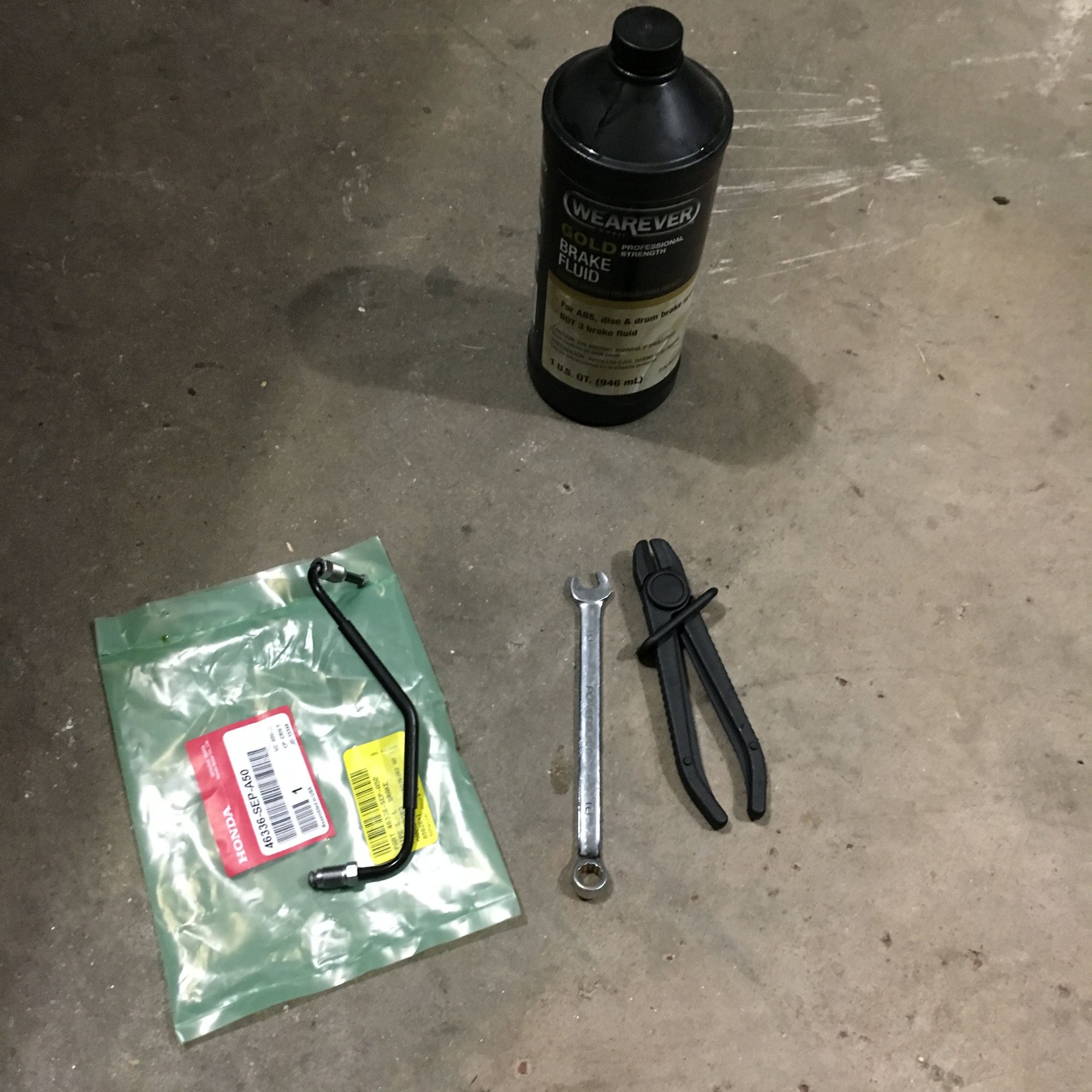

Tools and part ( cost me less than $5 . I also used a 11mm wrench to open the bleeder valves

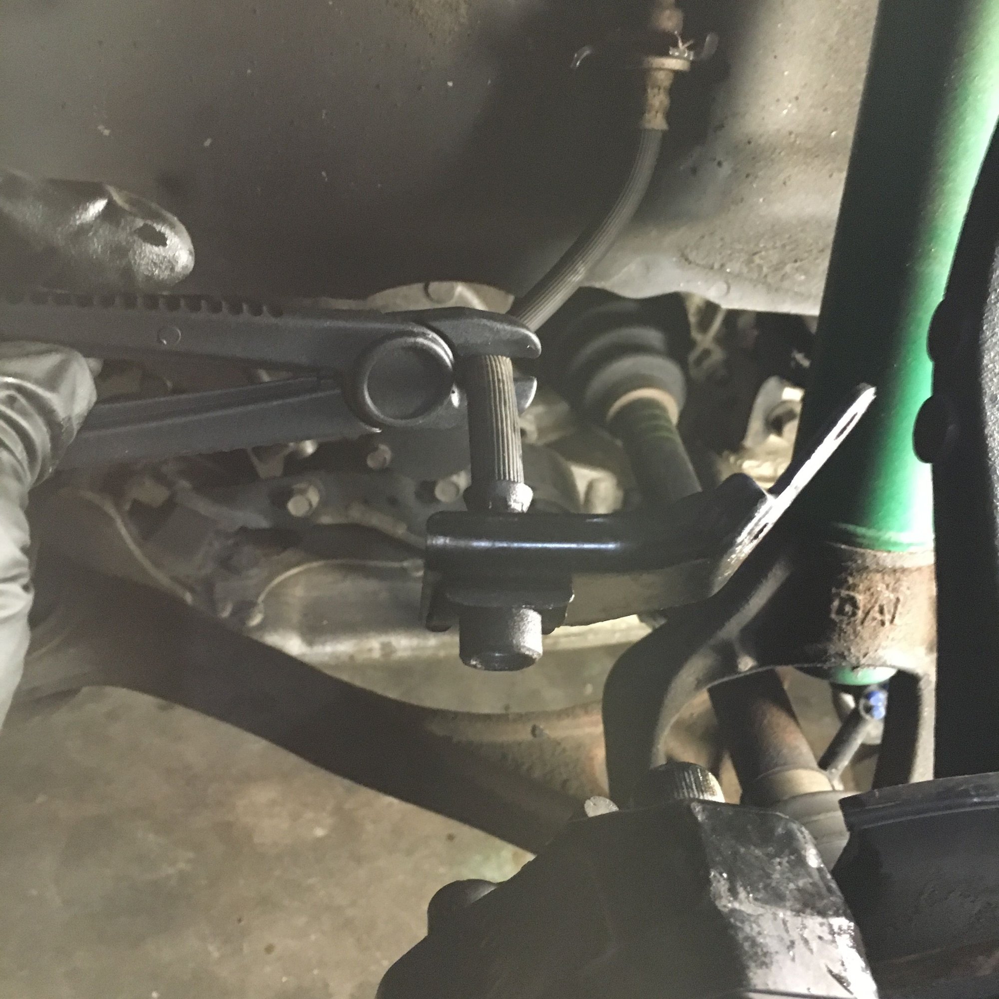

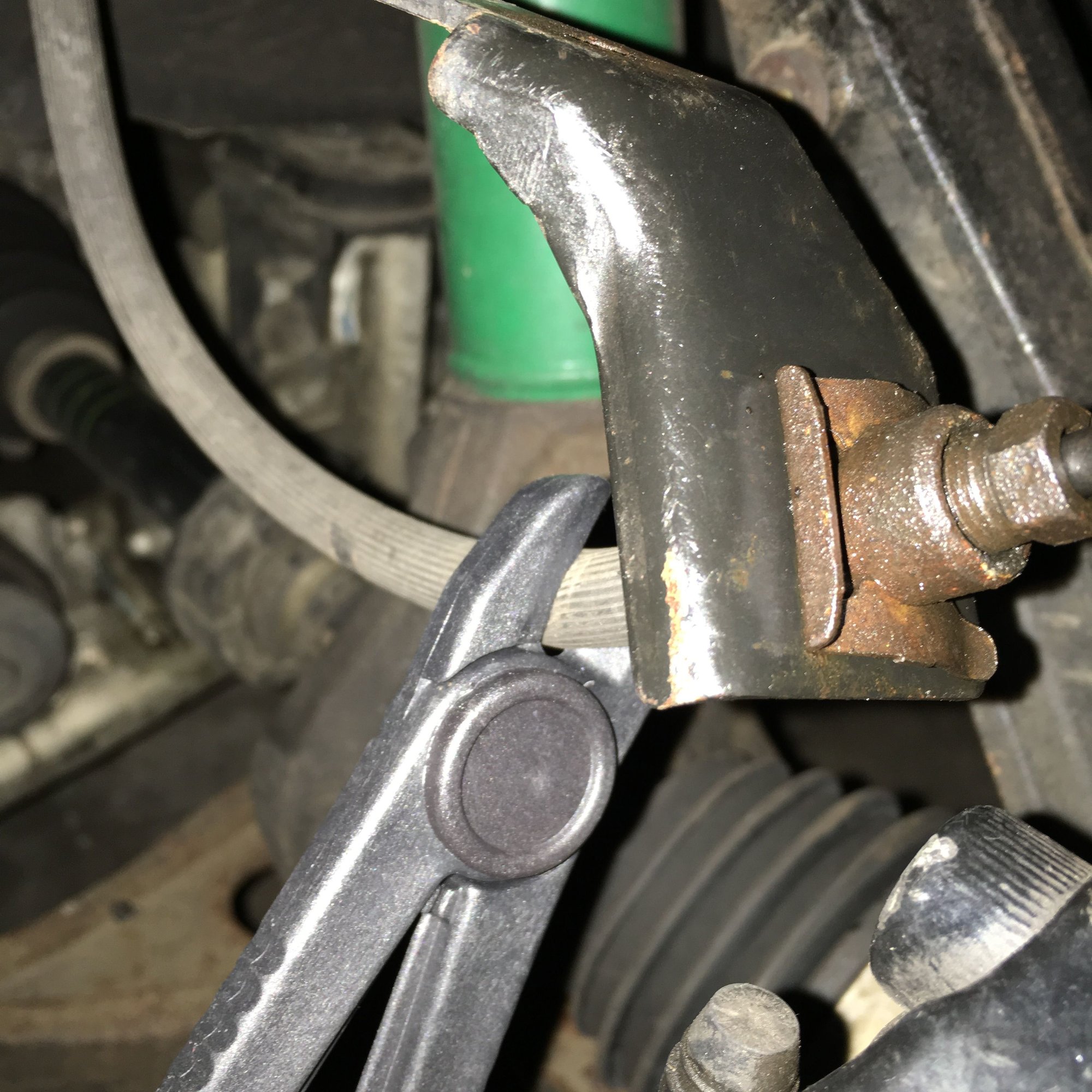

Line clamp to prevent brake fluid lost and minimize bleeding
Result!!
