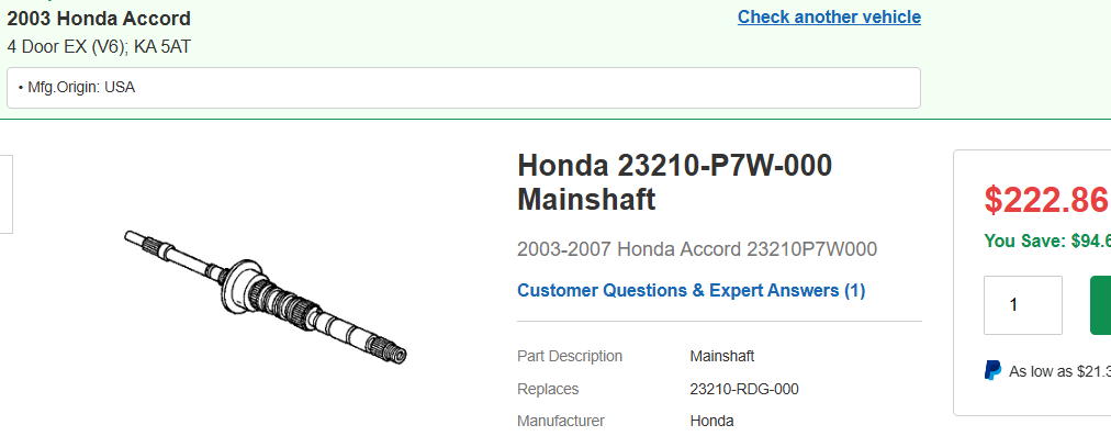

New information has me believing i bought a transmission from a 2003 model accord, would that have any difference at all in the mainshaft "tone ring"?
Not sure what that is exactly?
If you can provide a diagram of what it looks like or, preferably, a part number than one could research.
#3 below is the mainshaft for the 03 V6 Accord:
As you can see above, for example, it has shared fitment with the 03-07 model year Accords.

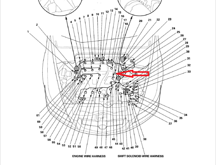

Which sensor, below diagram, from your 2005 TL are your referring to?

Number 15, the mainshaft input speed sensor.
