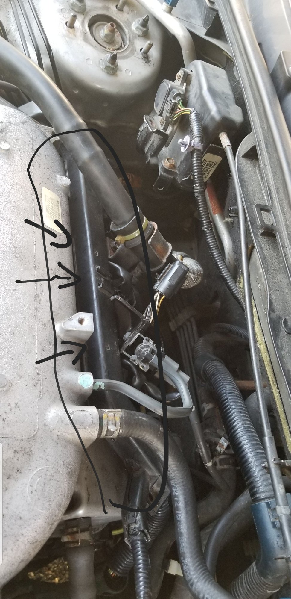

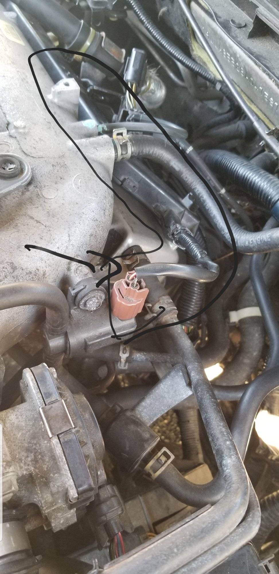

Originally Posted by frankjnjr
It may be helpful, if you could post a pic., of the issue your trying to describe. As ACURAte_titTLe questions, It would be somewhat ODD, for the coil pack connector, and or wires, to short, especially, 3, at the same time. If the wiring/connector, is indeed, the problem, you have a serious concern, and need to determine, first, what actually caused the short.
This piece has plugs that connect to coils. When i called the autozone they told me there are 3 different wires that are $50 a piece that what lead me to try and open it to see if indeed there its one whole piece or 3
I still have to test both pieces to see if there is power running through it.
