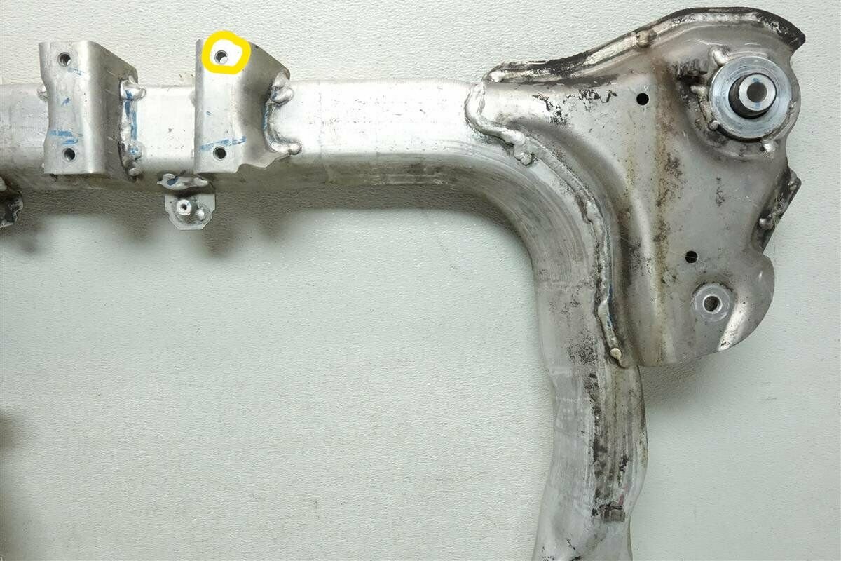

Old May 21, 2020 | 09:19 AM
Posts: 6,909
Likes: 2,211
Just curious, are the motor mount fasteners (yellow) on the front subframe pressed in metal nuts from underneath?

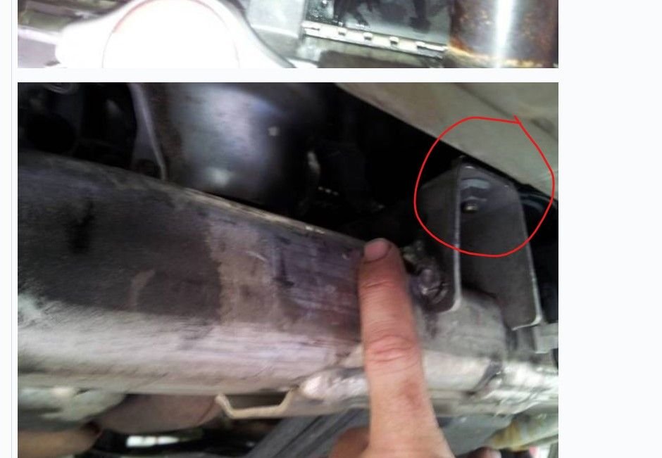

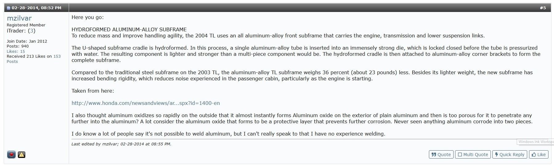

Originally Posted by zeta
Is the 07 TL front suspension subframe metal?
The subframe seems to be aluminum (see image and link).
No idea if there is a nut underneath. Given the OP stripped a bolt, I would imagine there is a steel nut underneath. Hard to believe aluminum could strip steel bolt.
https://acurazine.com/forums/3g-tl-p...e-help-906058/
Last edited by redbeard1; May 21, 2020 at 10:17 AM. Reason: changed metal to aluminum
I think there are nuts underneath.
https://acurazine.com/forums/3g-tl-p...-mount-854098/
Old May 21, 2020 | 07:45 PM
Posts: 6,909
Likes: 2,211
Nice job in finding a picture. There does appear to be some kind of factory pressed nut on the sub frame mounting points to receive the #35 Bolt, Flange (10X20) which are sold alone.
