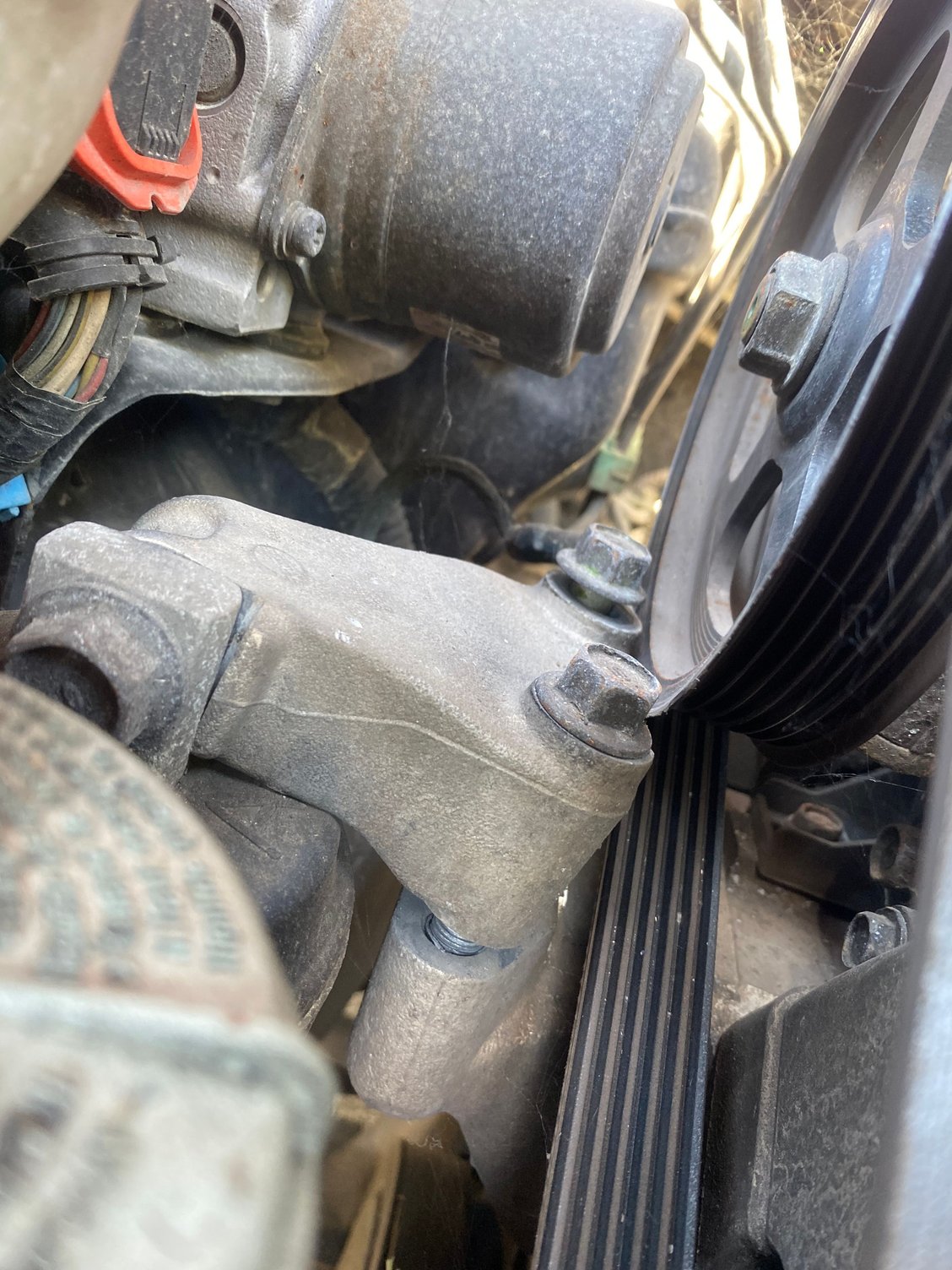

Passenger side mount bolts on my 06 tl auto base seem to be backing themselves out cause my pulley to drill into my mount. Anyone else have this issue or any advice?

someone over torqued the bolts...the mount is stripped.
replace mount.

well, i take that back..
remove the mount and see if the bracket is fucked...if bracket is fucked, then replace bracket along with motor mount.
but you can kind of see the aluminum strips/chips. meaning the bracket is most likely fucked.

Looks like #5 Bracket, Engine Side Mounting - Acura (11910-RCA-A00) either needs replacing or perhaps heli-coiled by a professional.

The bolts were loose from being stripped. You can see below the first one already backed out and and the rear one is more so.

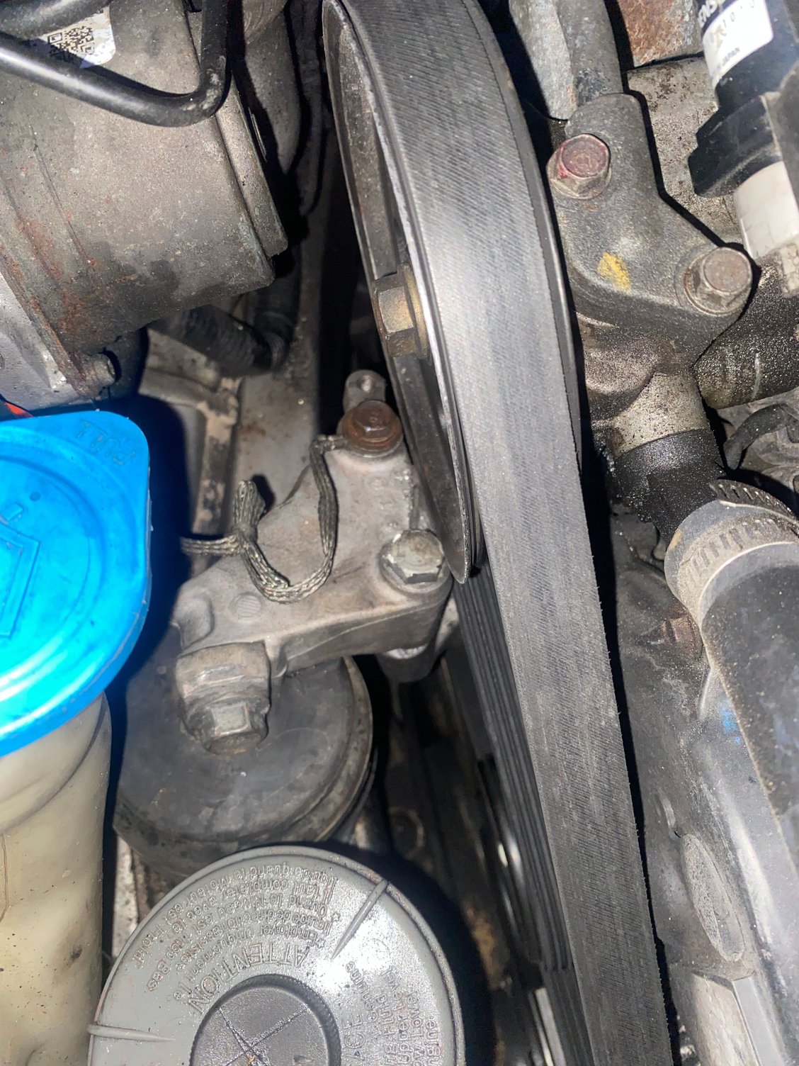

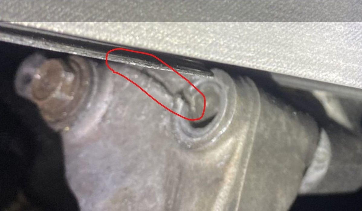

I think your top bracket is cracked (see attached image). If so, the bracket may not be able to distribute the forces correctly and that might be snapping your bolts.

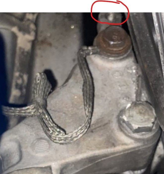

Also, the grounding strap is attached incorrectly. It should be attached with a small bolt in the area circled in red in the second picture. I can't imagine it could make a big difference, but the extra materiel under only one side of the bolt could cause issues.
Finally, your bolts don't look OEM. If you use aftermarket bolts, make sure they are rated for the same pressure.

@redbeard1 thanks bro and no that’s the grove that was made from the pulley grinding into the bracket. Nonetheless so I agree, I had oem ones n the mechanic said he didn’t need them. A.) B.) I do believe I need oem bolts/screws whatever however I also so some diagram that showed some

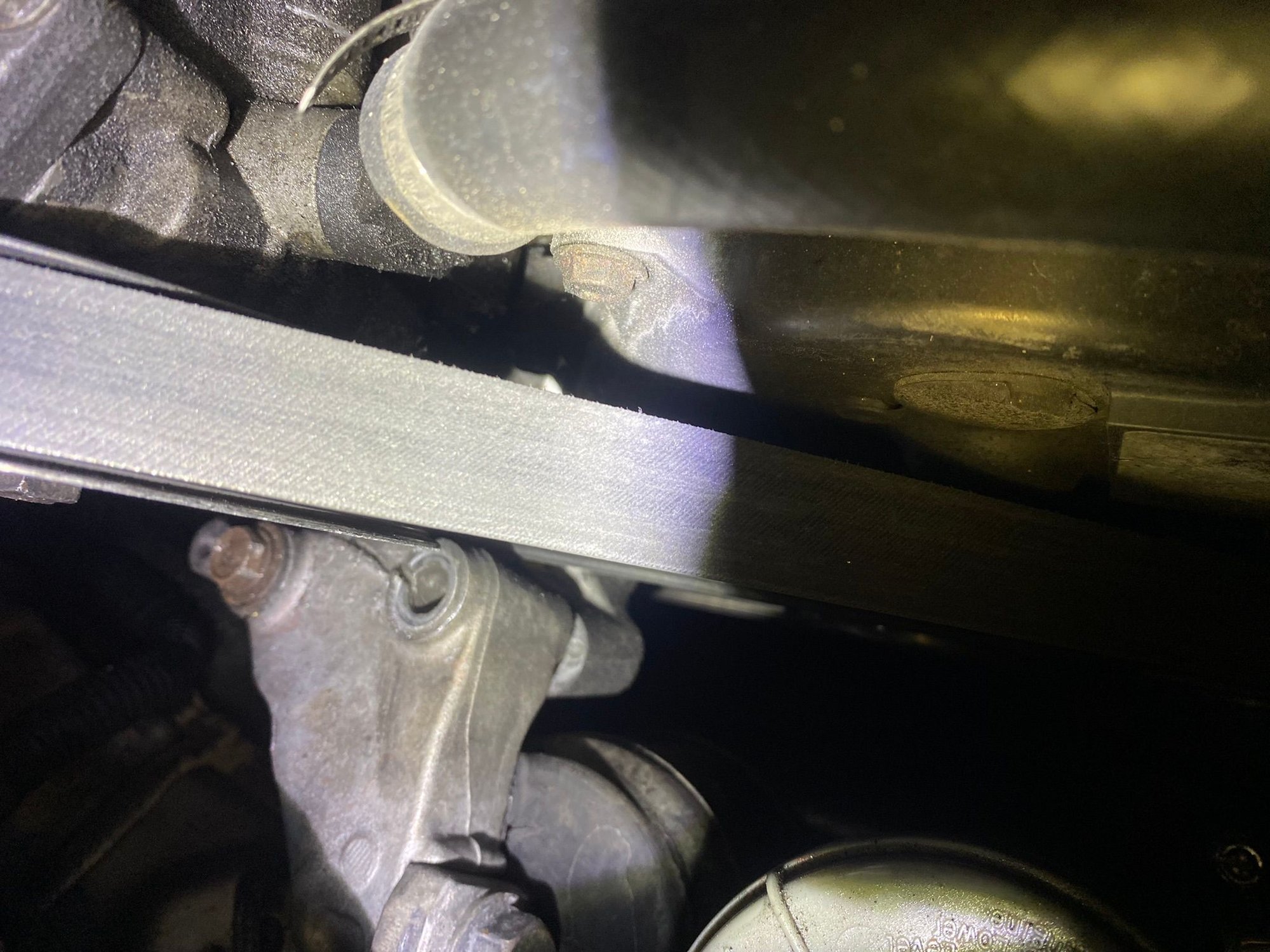

I'm not sure. It seems, given the amount of damage shown, that the PS pulley was partially supporting the engine at least for a while. I can't imagine the bearing was designed for that kind of load.
