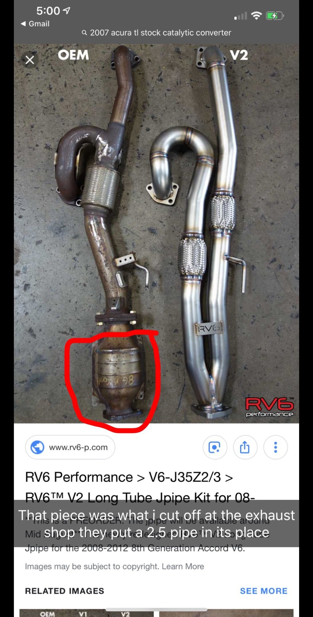

okay so i just got my catalytic convertor removed off my 07 tl type s and alot of random engine codes started to come up high voltage once it was cut my engine light is flashing which is causing a misfire in 1 or more cylinders what could i do to remove those codes??does anybody know any shops in broward florida that can tune the car to tell the computer there is no cat there

but all these problems came after i removed the supresser off the back where the J pipe ends

And that started happening once i removed the cat behind my j pipe
